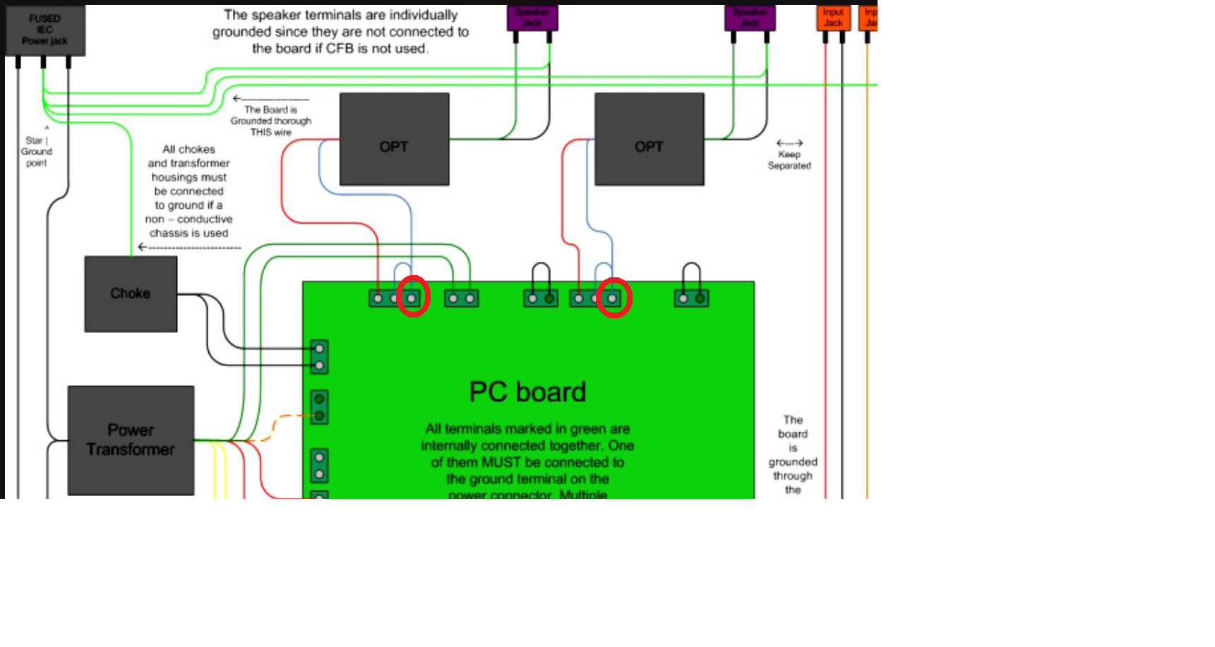

Hi everyone,
I wanted to let you know what's happened w.r.t. my SSE amp and the one crackling channel. [It's been a while...; I had to take some time off for the holidays, etc.]
I inspected the components on the board, the terminal connections, and the tube socket solder joints. I found a few issues:
  • A few of the wires going into terminal sockets were not very tightly secured. I was able to kind of jiggle them gently and get the wires to pull out of the terminal socket. This was most prevalent on the two terminals indicated inside red circles in the attached picture. I pulled the wires out, stripped off some fresh sections, twisted the ends and put a little solder on to hold them together and then re-installed and tightened very well.
  • I got rid of the screw terminals on the cathode resistors. I thought they were a good idea initially b/c I wasn't sure what value cathode resistor to use, but I've been worried that they don't allow for a really good connection between the resistor and the board. So they're gone and the resistor is connected to the board directly.
  • The tube sockets looked good, so did their solder connections to the board. I didn't see any other issues with any of the other components or their solder joints.
  • I changed the tubes; put in some sort of Electro Harmonix big bottle el34 type that's relatively cheap to replace.
Good news: it's working! I connected everything, cued up some Zeppelin, crossed my fingers, and it rocks. Sounds great. Thank you, all!
The only downside here is that I don't really know what went wrong or what to take away from this. It seems like the OPT connections at the screw terminals being loose could have been the issue. I'd appreciate input from anyone with more experience and knowledge.
One additional question: I'm not sure if the tube that was in there when it started crackling is ok or not. Maybe it was a tube issue and it's bad and I should throw it out. But is it possible that the tube is OK and I could continue to use it? If so, how can I check the tube?
