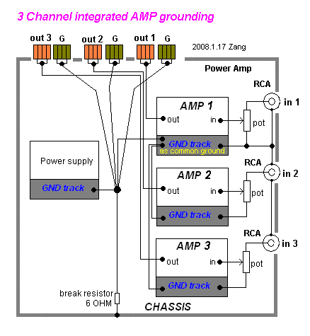

A very simple option that might work is to change the amplifier's bus ground topology over to a star ground topology.
The matter is definitely where pin 1 attaches to ground, definitely where input loads attach to ground, definitely where input jacks attach to ground, maybe also at pin 4 and maybe also at pin 2. The datasheet is not conclusive as to which pins are supposed to be a member of Signal Star ground.
Signal Star ground is created by adding a resistor of 4 ohms or 10 ohms or similar small amount. One end of that resistor is cabled to Power Star ground. The opposite end of that resistor creates the Signal Star ground.
Please review and compare other amplifier designs that use star grounding. Many of those are highly resistant to problems from computer source.

hm... understood. I'm going to build a power supply section for the amp, but not yet decide on material. What should in the construction ? unregulated power maybe suits it ? the PE just attach to the chassis, and loop breaker ?
Hm..... another point i'm not sure about is the 'signal star ground' you mentioned. So i just add a 4-10ohm resistor from the power star ground (which is power supply ground ?)
If i just put one end of resistor is input ground, opposite end is star ground ?

You can read the previous answer for the first time.hm... understood. I'm going to build a power supply section for the amp, but not yet decide on material. What should in the construction ? unregulated power maybe suits it ? the PE just attach to the chassis, and loop breaker ?
A link to the specific part is in post 15. Applying it and a ground loop breaker is post 28 and 29.
I cannot do better on a reiteration. Please review related safety grounding materials.
You can compare that with the many amplifier examples posted here at diyaudio.com Photographic and schematic examples are good.Hm..... another point i'm not sure about is the 'signal star ground' you mentioned. So i just add a 4-10ohm resistor from the power star ground (which is power supply ground ?)
