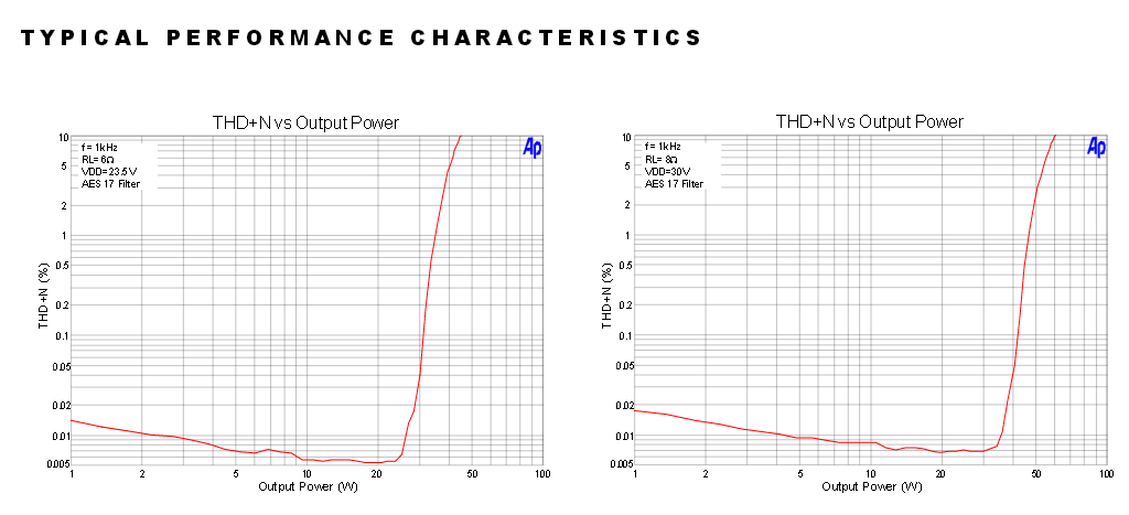

400W is a lot of noise. You've already had 2 of these blow up. When I want more power, you say. How much power do you want?
If you really need these power levels, you should think about trying to obtain them from an amp that is not being run at 100% continuously.
There could be a generic fault, but the chances are they blew up because you treated them a bit cavalierly. Settle down to a permanent or semipermanent arrangement and try not to cause any undue stress such as at switch-on or when plugging or unplugging speakers. Do not hot-swap.
