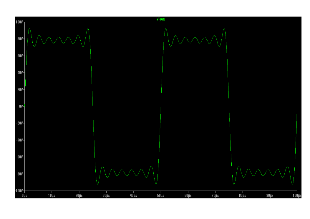

Man, as long as that amplifier is between 20Hz and 20Khz, on that domain of freq, the amp must act perfectly on sinewave and squarewave.
A rectangle can be synthesised from many summed sine waves of various increasing frequencies.
To produce a 20kHz rectangle with 80Vrms the amp has to produce the following sine waves at the same time:
70.7Vrms/20kHz + 23.6Vrms/60kHz + 14.14Vrms/100kHz + 10.1Vrms/140kHz + 7.86Vrms/180kHz + 6.43Vrms/220kHz + 5.44Vrms/260kHz + 4.71Vrms/300kHz + .... + .... + .... +
If you stop the synthesis at 300kHz the wave shape looks like the attached picture.
Reproducing anything which comes close to a rectangle demands from the amp to reproduce substantial amounts of much higher frequencies than the fundamental of 20kHz in the example above.
Filter functions of real amps do not exactly reflect the theoretic fourrier coefficients for the synthesis, so often the ripple in the roof is not there, often just round corners- but this depends on the specifics of different amps.
Regarding audibility:
If you compare the sound of 1kHz sine vs a 1kHz rectangle it will sound very different.
If you compare the sound 15kHz sine vs 15kHz rectangle you won't hear a difference, because the signal portions which make the difference are above the human limits.
Try it with your signal generator and earphones.
