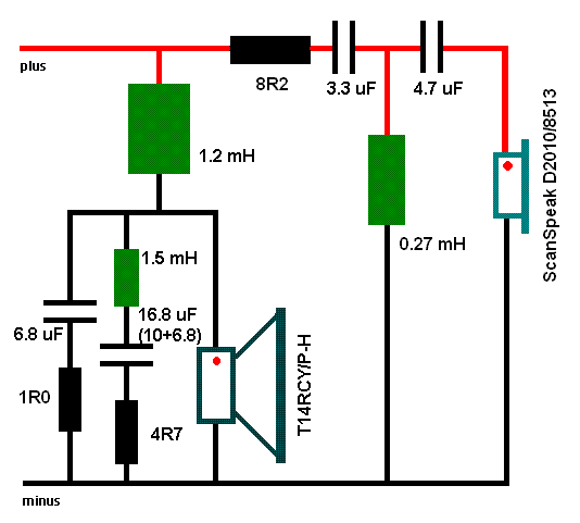

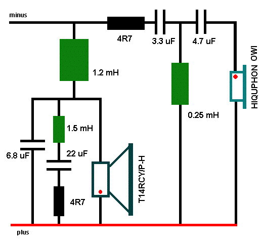

Proac Response 1Scrossover diagram needed
Anybody has the original crossover diagram ? Not a DIY/clone version with different woofer , not RS1 and not RS1sc but 1S . Also is Proac version of D2010 with or without ferrofluid ? This was never cleared out with all the cloning mania in the past. I know that the tweeter is not the same becuase I substituted one of the tweeters in Response 2s with standard 2010 and it was different . more efficient and raspy
Years ago I built a clone based on Troels project with optional Hiquphon Owi1 (no ferro) tweeter and original woofer and it sounds like a bucket of rusty nails. Speakers are boxed for several years and it's a waste of a nice tweeter.
Found an ad with a spec sheet. Says they have ferrofluid. Love the "see thru" woofers. 🙂
I'd imagine substituting tweeter with ferrofluid for the one without would require more substantial crossover reworking
I only had the original woofers from Proac RS1 since the owner upgraded to Rs1sC. Hiquphon was touted as a nice upgrade. The problem is the original woofers are not exactly the same as the ofc the shelf version used in clones ..
