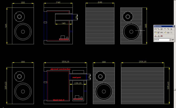

I am planning clone the Proac 1scs and I have a couple of doubts regarding the cabinet construction.
I was thinking of making the cabinets deeper but keeping the same internal volume for the cabinet. The idea of doing so is to have a separate internal cavity for the crossover to minimize vibrations.
Im not going to lie either: I want to make the cabinets in plywood a la Penaudio Charisma (www.penaudio.fi), and they will also look nicer eing a bit deeper.
The doubt I have is regarding the port for the bass reflex system:
If I add the extra depth and move the port tube further, will that affect the cabinet tuning or performance in onay other way??
I have attached an image with both options included:
On top - the original construction (dimensions are not final yet)
Below - the optional deeper cabinet
Any help will be appreciated, and BTW, if anyone has the precise dimensions of the original PROAC 1sc Id appreciate it a lot if they could pass them on to me... !
Thanks for the help,
B

It looks like your deeper box will move the port out of the box (the part the woofer sees). This will change the tuning. A secondary effect would be that the port inlet would now be baffled, and that would have some influence on the acoustic length of the port. So you would have to look at what the box tuning would change to and see if that would negatively influence the design. It could be that the volume change is insignificant.

Yes, to tell the truth, this are my first diy speakers, and although I don't understand many things yet, I had the impression that box tuning would probably change....
To tell the truth, I really liked the deeper cabinet: it looks nicer and the speaker would probably be a bit heavier and tend to rock less on the stands.
I anyone else has any comments, here I am.
Thanks again for the tip,
B

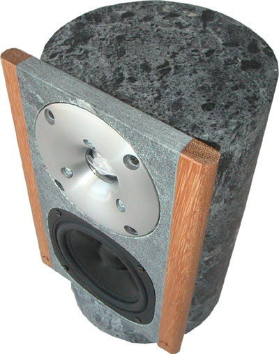

These are nice Finnish speakers too...
Made from (soap)stone
http://www.flinkstone.fi/hifi.html
Or how about speakers with 100% humidity and 120°C heat endurance for sauna? 😛

I have the exact dimensions taken from the cabinets if anyone wants them but it looks like most of you have.
As for damping it is the usual 5mm damping panels to the sides top and bottom – not the front or back and the inside is lined with 1” vitafoam. The stuff in my boxes is white but it is all much the same and you can get some from www.falcon-acoustics.co.uk for a couple of £ per sheet. It is simply wrapped single thickness around the inside with an extra piece behind the woofer to protect the XO which is attached to the back wall.
The http://audioclone.free.fr/responseONEsc.html site lists the dimensions which are accurate and the XO values are the same, as far as I can tell. Certainly the caps and resistors are the same so I think you can trust them. They have the same number of components too. The point is the Bass mid driver suggested is NOT the same.
The one illustrated uses a different driver than the original. However Seas do make another driver with the same cone material only on a round chassis, not the odd shape of the proac unit. I have a sneaking suspicion that this is actually the same drive unit. Lets face it if proac have such great success with the modified one Seas wouldn’t pass up the opportunity of selling a equally good one! Of course it couldn't be exactly the same though. The customisation I believe is the cone being put in the chassis of the old drive units which allow upgrades to be made and maintaining the standard appearance. Indeed I have seen it used in place of the custom unit in the future clone.
Matt
internal photos and xover double check
Hi Matt,
I am writing you in relation to the 1sc post you have recently posted on the diyaudio.com webiste.
I live in london, and to tell the truth, the 1sc clones are going to cost me roughly the same as the commercial speakers themselves.
The reason for wanting to clone them is simple: I like a lot how they sound, but I don't like how they look, so what I am trying to achieve is the same sonic performance in a much nicer package....
I know that there are many diy speakers around that seem to be "better", or that I least use more expensive drivers, but I already know that the 1scs will work well with my sugden amp, and I prefer to play it safe with speakers, since as you already know are very system dependant.
(I tried the future 05 and the response d15 with considerably worse results that the 1sc)
The french audioclone site doesn't inspire me much confidence, to tell you the truth, since their Proac Future 05 or Response 2.5 clones bear no resemblance to the original Proac crossovers.
I recently found a person online who provided me with the original (?) Proac crossovers.
I haven't yet ordered the components, since I wanted to check their values with someone else before posting the order.
They are quite expensive: Hovland musicaps, mills resistors and Alpha-Core air core foil inductors. The crossover components alone sum up around £300, excluding internal cabling and binding posts (WBT).
According to this person, he upgraded his 1scs with these components and he states that the rise in performance of the speaker was amazing. Crossover design and components sum up to 80% of a speaker performance, so I guess it is more than worth it going with good quality components.
Apparently the Proacs use the cheapest crossover components available, so I am very excited of the idea of having an even better loudspeaker than what I have listened to at hifi shops....
Now, coming again to the crossover: the crossover in the french audioclone site is quite accurate (90%), but there are no components on the positive side. The electricity goes directly from the + in the amp to the + in the speaker, and only has the caps and resistors in the negative side of the crossover.
Since you already know the insides of your speakers, could you check this for me?
(I would really appreciate it)
I would also appreciate it if you could email me the dimensions of the port and its precise location on the back baffle, as well as the length of the port tube. (THANKS!!!!)
And since we are already at it: could you email me some pics of the speakers from the inside so I clearly know what and how to damp the speakers inside?
If you have any other tips, like variable wall thickness, precise values for croover components, etc etc etc, I would also appreciate it a lot ,,,,,
And of course, once I finish the speakers, you are more than wellcome to come by and listen to them. That way you can allways consider if it will be worth for you to upgrade the crossover components at a later stage....
You can bring the records you already know and I will take care of the wine or the beer (which is the best system upgrade I have ever found: cables don't even come close!!)
Thanks a lot for the help!!!
Best regards,
B
Hi Matt,
Best regards,
B
