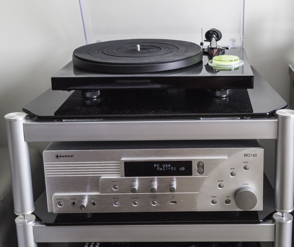

Pro-Ject turntable with a red Ortophon cartridge.
Hello all. I own a Pro-Ject Turntable with a red Ortophon cartridge connect to my Outlaw RR2160 receiver (witch I love). However, when I'm using the turntable the level of sound is much lower than the PC-USB input connect to my computer system. Not only the ''level'' of sound is low, but it seem ''thin sounding'' as well. Should I change the cartridge or should I buy a decent phono preamp ? Maybe I would like a tube phono preamp for warmer sounding. Thank you for your opinions.

Hi BOTH,
The Red is one of the WORST sound cartridges available, but it has a healthy output at 5.5mv. you can get better sounding Golding carts that have a 6.5mv output, but than in itself will not be enough to significantly increase you gain. Another option, changing the stylus of the Red to a Blue will improve the S/Q
So you need a separate phono amp that will do the job, Look for one that has various gain selections. There are plenty of very good phono amp kits on this site.
So it really depends on your DIY skills & budget to recommend further.
Cheers

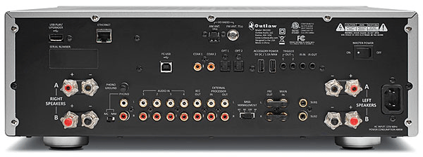

It could be that the needle on your Ortofon Red has been damaged or is simply misaligned.
It could be that the phonograph preamp section in your Outlaw receiver does not have much gain and so you hear a lower sound level from your records.
It could be that you have the outputs from your turntable connected to a line level input on your Outlaw receiver, and you're hearing the unequalized output from your Ortofon Red. That would be ''thin sounding''.
Have you checked connections?
Have you checked the alignment of your cartridge in the headshell?
Have you examined the stylus to see if the cantilever isn't bent, or the needle is in good condition?
The sensitivity of the MM Phono input of your amp is 3.3mV/47kohms so the Ortofon Red should drive it adequately.
Your description "thin sounding" and low level of sound makes me want to check that you don't have the turntable plugged into one of the "audio in" inputs instead of "phono".
