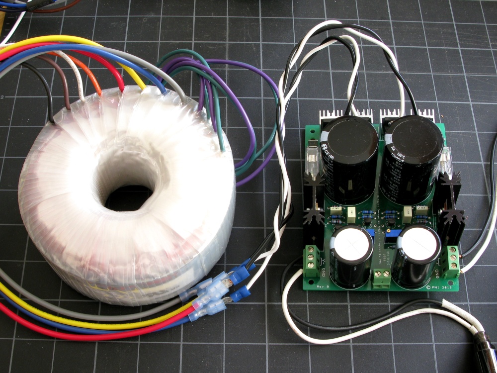

I have noticed some mechanical hum or buzz (no pun intended!) at rectifier frequency (2x mains f) when loaded with the typical bridge-rectifier/cap filter. Not enough to annoy me, but more than some people would like for a completely quiet power supply.

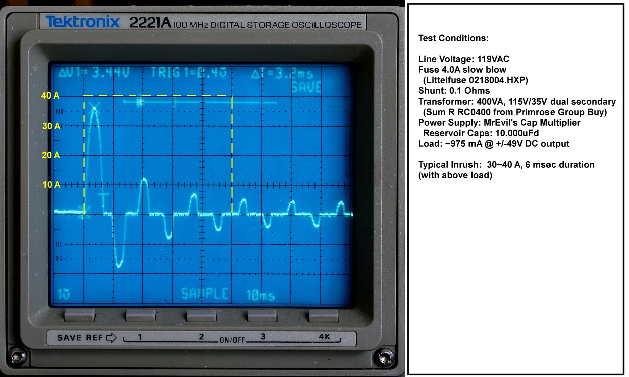

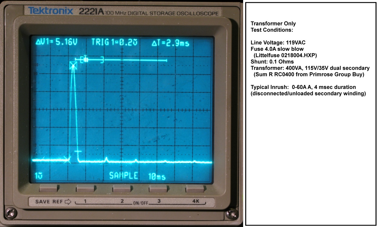

Aside from that, I started doing some tests for inrush, and load regulation with a couple versions of Mr Evil's Cap Multiplier PSU.
(Same psu pcb that I know a couple people here have ordered).
For those cases specifically, see results below:
The first picture shows worst case inrush captured w. transformer alone and no load. Second pic shows a more realistic inrush with a 10.000 uFd filter cap. Large filters will produce greater inrush. The inrush measurement is normalized to 10 amps per division on the screen. The yellow dotted line is part of a separate discussion (OT here). Third pic shows transformer and PSU used in the test.
