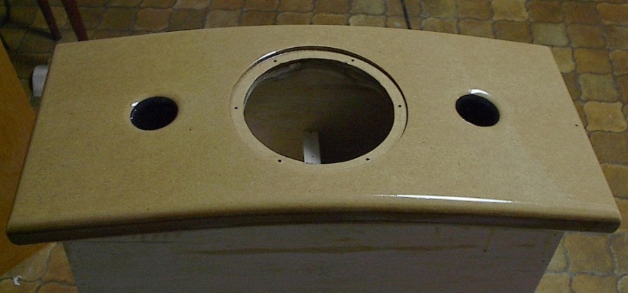

Yes solvent based primers are what's recommended because of the obvious risks with water and MDF. Sherwin Williams or Zinsser is a good top name brand. Most except the varnish based ones will require initial thinning with mineral spirits.
I have had the best results when I used solvent based polyurethane as the sealer, then a solvent based primer. I let the poly dry overnight and sand lightly with fine sandpaper before priming.
This method hasn't let me down.

Using oil based polyurethane as a sealer you could pretty much use any primer on top of that no problem, but at 3 times the cost /gal of an oil based primer, I'd personally wait to use the good stuff as a hard protective final overcoat. I just stock up with the Zinsser B-I-N primer and use that in my gun on everything not needing a lot of sanding/smoothing. Sanding between operations is standard practice, so the goal is to cut down on unneeded steps, YMMV. I can see the point of trying to seal the inside of cabs in high humidity, but it's (poly) not really gonna work for moisture over time anyway ie definitely can't make MDF exterior grade.

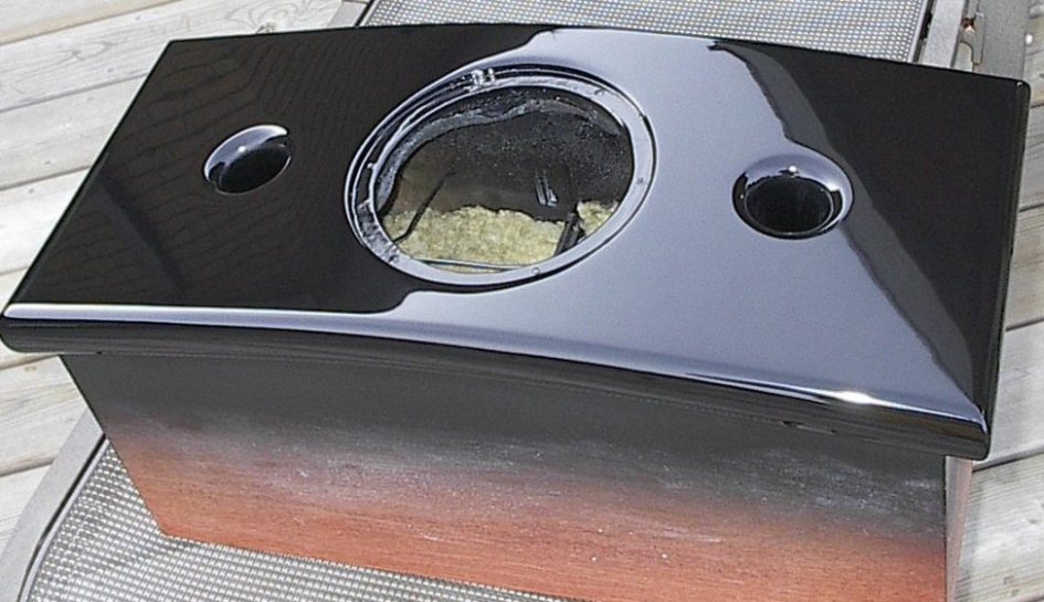

Damn that looks good!
Care to post the steps required to achieve that type of piano finish? I don't expect my speakers to look this good but I will like to achieve some type of high gloss finish.

I use solvent based (not waterbased) clear polyurethane to seal every MDF surface, inside the enclosure too. This can be sprayed or brushed on. Why polyurethane? It doesn't separate when it's absorbed into the wood grain. Other, oil based coating may separate (the solvent - oil - gets absorbed into the wood grain and what's left sits on the surface). Polyurethane is VERY moisture resistant - it forms a barrier and keeps the MDF at a constant moisture percentage even when the humidity in the air around it goes up and down. It's a very important first step for a great paint job on MDF.
Primer. Once again I like to use solvent based primer. It takes longer to cure but is an added barrier against moisture (water is the enemy). I spray 10 or more coats, letting each coat flash (dry/tacky to the touch) before spraying again. This can take a few hours, depends on how warm the temp is.
After the case is primed, let it cure for several days. It should be ready to sand smooth when it resist a fingernail dent and the sandpaper doesn't get clogged up when sanding it. I dry sand the primer to 320 grit.
Topcoat. The speaker in the pic above was sprayed with 10 (or more) coats of water based black polyurethane. This is a special order from Sherwin Williams called "Armorseal". It is high gloss industrial floor paint. It is tricky to spray because it is so thick (reducing it too much weakens it) but it dries VERY fast and polishes (as seen in the pic) very well.
Another option that I have explored is a solvent based colour coat (3-4 coats) and a solvent based clear over that (6-10 coats). The clear can be clear polyurethane. As usual, give it several days before colour sanding and polishing.
