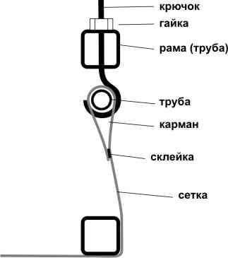

about mylar tension (this is billboard construction section, the same concept):

Nice, thank you.about mylar tension (this is billboard construction section, the same concept):
Looks fixed at the bottom bar with a tensioning bar/rod at the top. This would indicate that the sides are not secured, or at least cross tensioned in three dimensions.
I want to end up with a method to tension a curved/complex shape similar to an animal skin shield.
