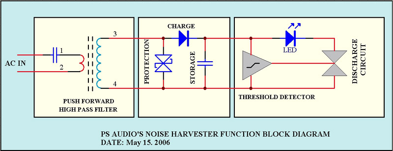

ltspice tell me the the workings of the circuit.
the diodes act as a threshold for the dc component. without the diodes (rsw=1mohm 1A as the 10H coil is 1ohm).
with the diodes much less not zero , but tolerable.

just took a diode available in the LT library that was 3A to demonstrate the operation. take any diode you like. you need more diode pairs if the dc offset is larger, and dissipate more in the diodes.
the offset might originate from unbalanced loads elsewhere in the grid.

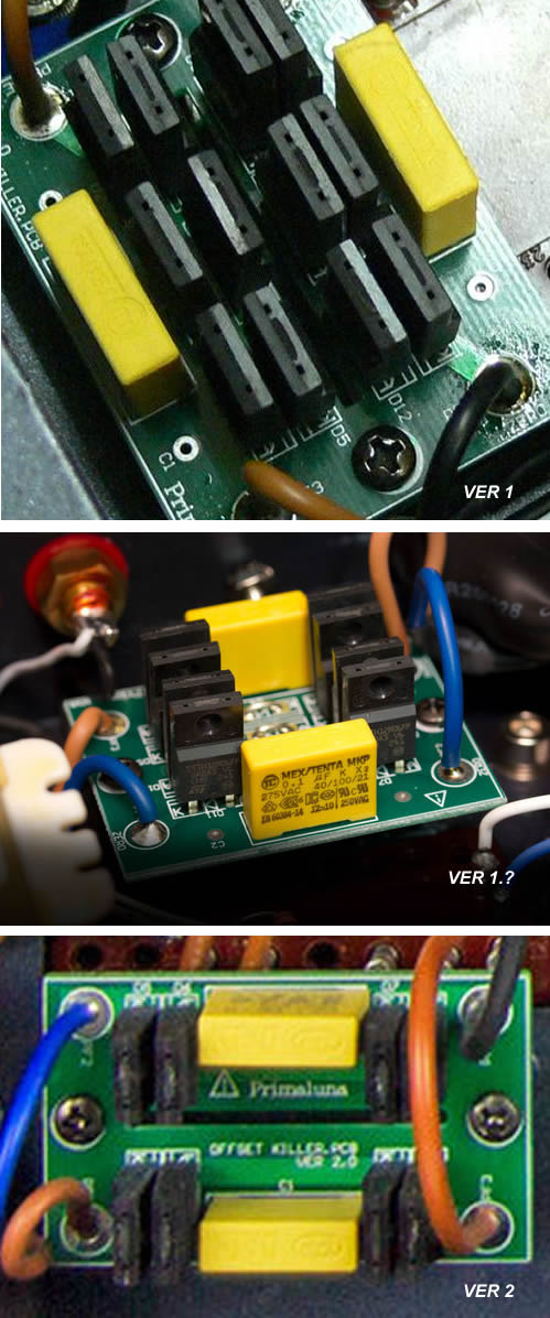

Yesterday I built the ver2 and installed it in the power strip for my audio equipment. Playing the same Chesky records tracks, these are after effects so far:
- the slight mechanical buzzing noise coming from my amp is gone. The amp is completely silent.
- for the same volume (28 out of 80), it's louder.
- the bass is stronger, more defined
- the soundstage is "clearer"
The most obvious change is the volume.
I've found another DC offset blocker. It looks very similar to Primaluna's isn't it?
Except in this one they have huge amounts of capacitance. Effective impedance in series is 318mohm at 50Hz. The Primaluna's 100nF has an impedance of 31.8kohms and must be there only to snub the diodes. The diodes do block the DC and do have low resistance, also the 1.4V or so isn't musch compared to the mains. Perhaps that is good enough? Maybe the large capacitance isnt necessary? I must build and try it out myself.
I’ve built the primaluna’s ver2 (post 31) based on the basereflex’s schematic (post 21), twice:
- for the hi-fi’s power strip in my living room (int amp, dac, apple tv)
- for the power strip in my bedroom (headphone amp, tube buffer)
Same feedback: it’s louder and the bass is stronger and more defined. I also dare to say the instruments resonance has improved.
It will be interesting to see the measurements before and after.

I used the exact same type of diode and a slightly different capacitor for $22 per circuit, board cost not included.
I have a couple of questions for you:
- why did Primaluna use this circuit on both Phase and Neutral power inputs?
- which design do you think Primaluna used for their ver2 board?
684619d1527961402-primalunas-ac-offset-killer-offsetkiller-jpg
or
I dont know. I would think DC block on one of the two lines suffices. Perhaps the same reason some use double pole switches or fuses on both lines, gives us a nice gut feeling tho may not be necessary.
I have no idea which ckt Primaluna uses. I'd just use a single block on one phase.
