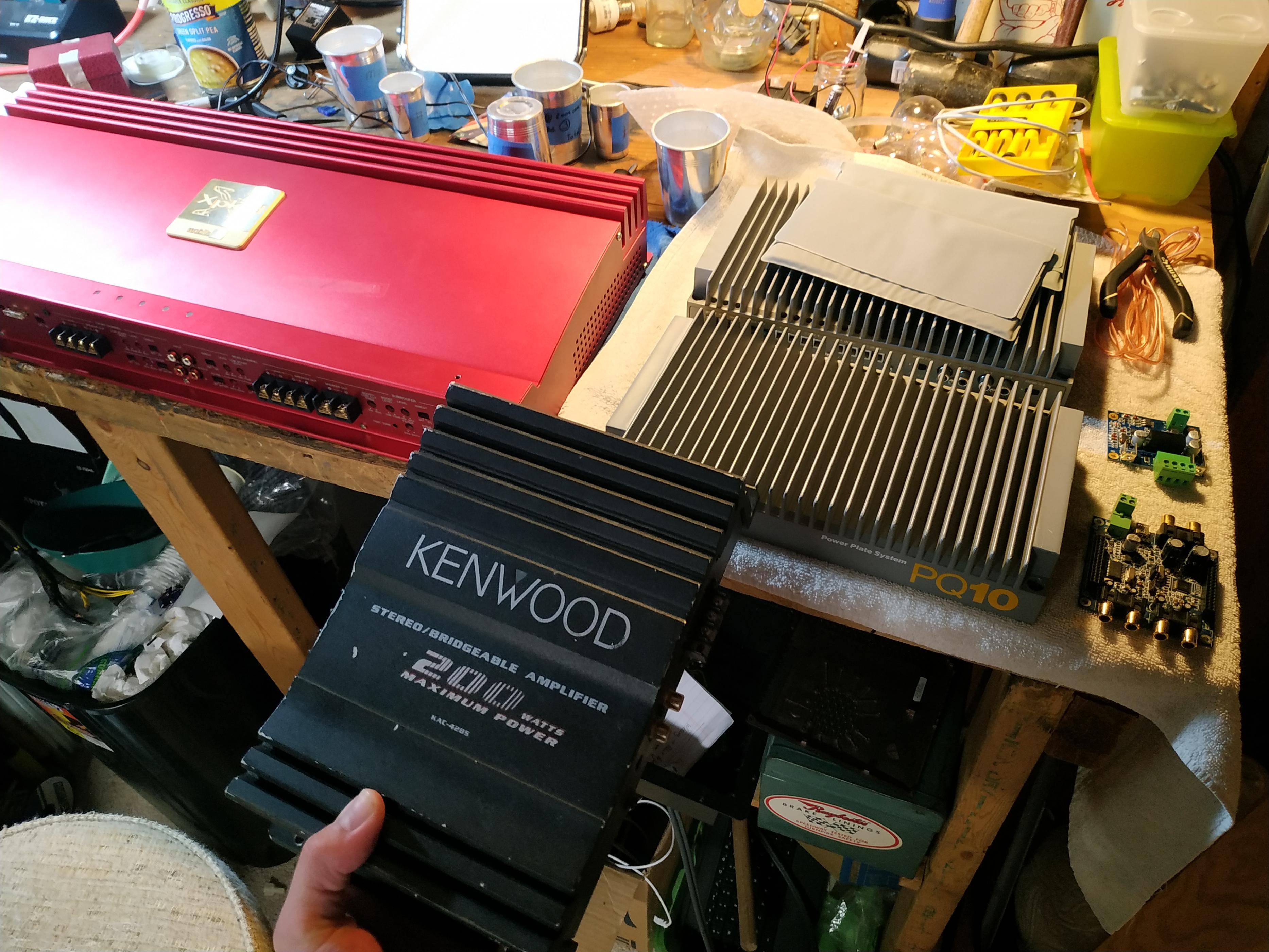

I am going to do a build in my 05 Volvo xc90 with some vintage amplifiers. I like their sound!
I am debating using a couple of the following, Set of Two A/D/S PQ10, or Sony XM-7557, and maybe a Kenwood KAC-4285...
That being said, I want to keep this system rolling as long as possible. I have some basic amplifier repair (for home and automotive) and am wondering what your opinions on PREVENTATIVE maintenance for these puppies..

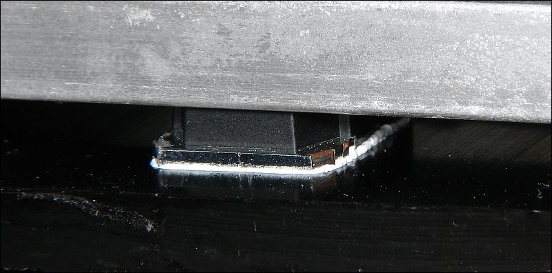

Also, replace the thermal grease, usually it dries and becomes useless.

The A/D/S are good quality amps, highly regarded in their time, better reputation than the others. 4x40W from around 1987-1991, I installed quite a few of them and their brethren. Clean was the typical word used to describe their sound. Gain controls are accessable through holes in the heatsink, you'll want a tiny plastic screwdriver to adjust them.
The Kenwoods of that era were not quite in the same league, yours is a little newer than the A/D/S. I'm clueless about the Sony.

I powered up the Sony because, it's big and it's red... It worked when I bought it, now no sound out of front left. I though, well let's check it out.
Rail voltage is +- 5% between them, so skipping the power section.
Checked the outputs in board and no dice.
Then went to the bias adjust point and I get nothing between tp6 and tp7..
I have really only had experience in output and power supply stuff. I am thinking a problem would cause a short in the voltage stage or differential amp to get me no idle current. I will do some reading in the service manual to see if I can get some learning in.

Hey all, I just got in a container of Dow Corning 340. Easy as clean with 90%ipa then speed a nice thin layer to fill the surface inconsistencies?
Going to do the Kenwood and A/D/S first because of the issues with the Sony..
