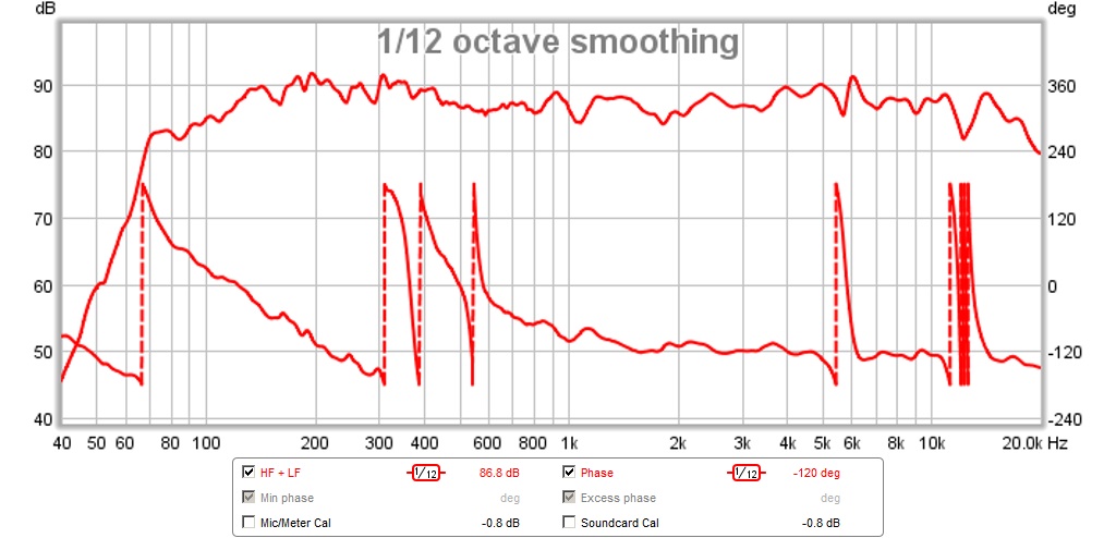

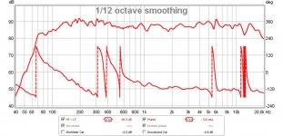

very nice build. Whats the level of smoothing on the last measurement in post 1.

Wow soundclip pretty good "pure - calmness - soft coherent". Could plot of phase turn be interesting.
Ok, I tweaked the EQ a bit more, nothing drastic and it really cleaned up the phase and impulse response. Listening to it, it sounds even better now. The phase is actually linear over a pretty good section of the critical 500Hz to 5kHz range where spatial cues and imaging are important. Probably from 600Hz to 5kHz seems to be without phase wrap.
The impulse response is approaching perfect - still a residual 6khz ringing at low level but not too noticeable.
I am pretty happy with it.

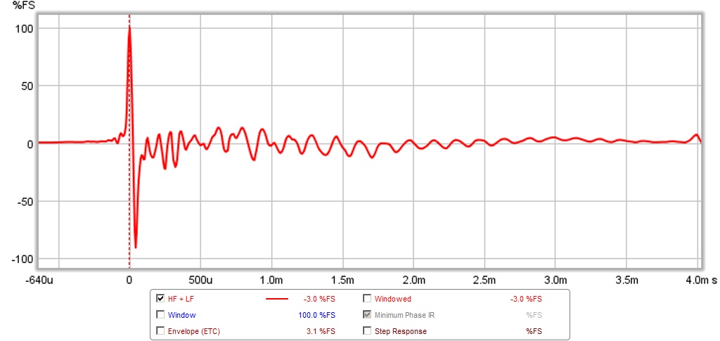

Here is impulse response.
From this impulse it seems the Vifa starts (upward spike) and the woofers follow in negative polarity (downward spike) to the Vifa? It is often said that the Synergy concept sounds as if it is one driver but an impulse of the single full range speaker in the same horn doesn't have that peak go up and down:
Just that one spike... Halair's impulse looks a lot like that last one.
So basically it is not quite a time coherent design but it is acting as a point source due to everything radiating from the same (virtual) point in space?
Wesayo,
The up-down spike function is dominated by the Vifa (or whatever unit is serving as the tweeter function). Depending on the EQ used on just the full range unit, I can get it to go up down or down then a little up. In fact, if I showed you the impulse response of just the Vifa full range, it will look almost identical to the up-down one in red. The woofer having a low pass filter of 300 Hz will at most have 3.3 ms risetime. Note the circa 5 microsecond risetime in the first peak and the successive bounce corresponds to 20kHz. At the 3.3ms timescale you can see a much more gentle broad hump - probably corresponding to the input from the woofer. If I had run the woofer fullrange, it would have more dynamics showing up in the IR - but would look bad as the response of the woofer through the 5cm port from behind a chamber has quite a ragged shape.
Hope that explains it.
