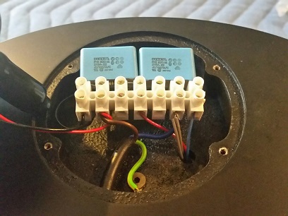

I have a Wilson Benesch Circle 'table. It uses a Premotec 250 RPM 50 hz motor with a very simple control circuit. A/C to switch/fuse holder then to circuit that contains 3 parts. 2 film caps at 22nf ( .22uf ) and a single 1 M ohm resistor across of the caps. The caps are wired in series.
The issue is that every few times the power switch is engaged the motor will not start. It does get power as I can feel it vibrate. If I give the spindle a very gentle nudge the spindle gets going. It happens about 3 times out of 10.
I have replaced the motor, caps and resistor. I have bypassed the switch and fuse holder to no avail. Cleaned the switch and resoldered all connections. No joy.
I contacted WB and they are baffled. A trip back to the UK for service is not cheap and I just can not see how the circuit can have failed after 10+ years of perfect operation.
The issue happens with or without a load ( belt connected ) to the spindle.
Any ideas of experiences would be appreciated.:scratch:
Mike

Are you sure these caps are wired in series mosttimes you need about 0.22 uF on these 9904 PM motors .
Measure the two coils for DC resistance. If vastly different that's likely to be the cause. Oil has been a problem with similar Airpax types. Usually a black gunge is seen in the bearings if the wrong oil used ( motorcar oil is not ideal, sewing machine oil will flush it out).
The motor can be opened if a coil is open circuit. If the coil can be resoldered to get the same readings +/- 10% the steel can be filed to remove the zinc coating at the riviting points ( 3 flat sections on the join ). Normal 60/40 solder will solder steel if the iron has enough mass and power ( > 40 watts ). Linn repaired some motors this way I seem to remember in the 1980's. 0.22 uF ( 220 nF ) or 0.15 uF USA 60 Hz is usual. Class X2 caps seem the best easy to get types, 275VAC is a typical rating often with a 630VDC in the UL regs if given. I doubt 630V peak will be seen.
Some older versions used a 15K > 3 watt resistor from 230VAC Live/hot to red motor phase and a 0.22uF red to blue ( no problem if neurtal and live are exchanged, it's just a convention to have the resistor to hot ). The two spare wires often grey to neutral. If that works it is an answer. This assumes a 115 V motor. That really should work if nothing else does. 90VAC is what a typical early Linn used red to grey, sometimes 80VAC blue to grey. You might try 95 to 75 VAC to find your preference by using 15 K to 20 K I would guess. It is hard to say if your motor is exactly the same ( check makers PDF if you can ). Try 2 x 15K first to get an idea ( 30 K in series, might be 60VAC, the motor should stand 130 VAC for a brief test, doubtless the motor would be OK, the turntable might get hot ). A capacitor balast is prefered as it runs cold, it could be more trouble.

Thanks for PDF. Clearly it is the one I know. With propper regard for safety could we have some AC measurements when it runs. Red grey and blue grey. 80 Vrms is about the minimum for it to start on load. Washing up gloves are what I use for safety, not ideal. Better than taking the maximum risk. Solder on the meter prods is safest.

I replaced the entire power supply and motor, bypassed the switch and fuse holder. It works! That is until I install the brass pulley for the belt! As soon as the pulley is on the motor shaft it goes back to intermittent! Very confused!😕😕

Update: Wilson Benesch replied several times and we have a solution. The 2 caps and one resistor network were designed for 230V operation. I removed one 22 uf cap and the 1 M ohm resistor and the motor works every time. The odd thing is that this 'table operated 100% flawlessly here in the US for the last 14+ years.
Thanks to all who replied.
