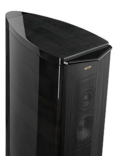

After a ton of additional research, I may back away a bit from my initial desire for 'no rectangular boxes'. I read a lot about the Elsinores (ScottG mentioned them earlier in this thread), and a fair bit about the Statement IIs from Speaker Design Works.
Though I would have a ton of fun building something like a boat-hull variant of the Elsinore, that would probably require a bit of a reworking of the crossover, for which I don't really have the requisite knowledge (yet). Reading through Joe's writeup on his site about the Elsinore, it sounds like even minor tweaks to the cabinet (such as corner roundovers greater than about 6mm) can have deleterious effects on diffraction, which has been so carefully modelled and accounted for in the crossover. I guess I am still sufficiently uneducated to know what I can and cannot get away with.
So that brings me to the question about the Elsinores vs the Statement IIs. Would one be more preferable that the other, overall performance-wise? This is a totally subjective question, I understand. In scouring the interwebs there doesn't not seem to be any comparison between the two - that is, no real discussion from folks who've had a chance to listen to both.
My listening will be a majority 2 channel music, with perhaps 30% movies. The added benefit to the Statement IIs is that there is a design for a center channel to compliment them.
-Note: the "boat hull" portion of the design is the rear of the loudspeaker, not the front - so you could still do the very same baffle front and alter the rear to that shape. The only thing you would have to account for is volume (..basically the resulting loudspeaker would be considerably deeper than "stock" Elsinore's).
