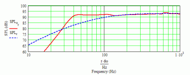

GM
Joined 2003
Simple MLTL:
H = 55"
WxD = 56"^2
tweeter centered 19.25" down from top
3" diameter x 3" long vent 44" down from top
All dimensions approximate and inside [i.d.].
The sim assumes a 1 ohm series resistance for wiring, etc., minimal damping and is approximate since I can't show the minor averaging of the pipe's 1/4 WL action going on due to the drivers being above, below the tweeter location a bit.
GM
