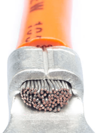

Cold weld (crimp), though inexpensive crimpers are a 'mixed bag' WRT how good it is, so for ground have historically done/recommended twisted together, 'embalmed' with appropriate electrolytic paste and crimped.
Either type depending on the needs of the app, the critical part is using the correct UL/CSA crimping tool for the lug design, which historically was only sold at industrial supply houses, though last I noticed years ago the local NAPA had the proper automotive kits.

Bummer! From Wirefly (attached), note that this is anything but a true cold weld, i.e. with a naked eye we should see a ~ solid mass at the exit of the wire/lug joint; but in a low voltage app (<600V), history has proven that odds are it will be fine for most typical apps unless the joint is used/abused in a high volume assembly line app and/or the crimped joint isn't in a ~ continuous duty cycle such as a daily driver vehicle, etc.,
The many/various electrical problems me n' others have solved on various vehicle, construction, etc., friends, forums, etc., have by far been electrical connections with poor grounds being the majority; ditto in the industrial apps I've been 'up close and personal with', so at the least make sure you've got ~ 'bullet proof' connection joints by using the appropriate chemical to lube/vapor seal it or at least always have petroleum jelly or similar close at hand and if working in a very cold environment and/or want to keep folks from guessing what the @#$% you're using you can thin it using (tiny amounts) of (red) hydraulic brake fluid.
Unless industrial/'hard'/high silver content solder is used, best overall cost/performance wise to use UL/CSA, etc., wire nuts with appropriate lubricant suitable for the app.
