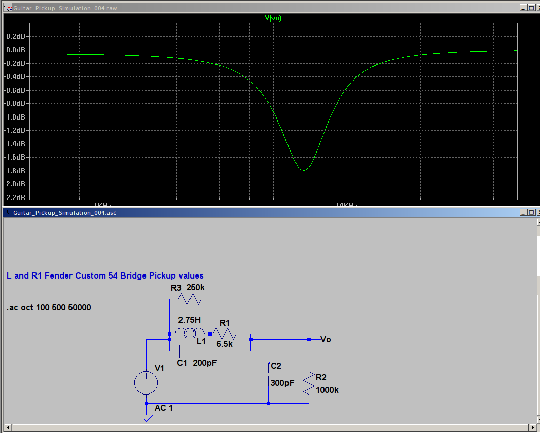

As a first step, I thought it would be interesting to do a few more LTSpice simulations. I was right, a few minutes with LTSpice was enough to have my head spinning with new thoughts.
Take a look at the attached screenshot. In this simulation, the guitar pickup is loaded only by a 1 meg-ohm resistive load. (Note the 300 pF cable capacitance is disconnected).
Here is the surprise I wasn't anticipating: at the pickup's resonant frequency of roughly 6.5 kHz, there is a dip in the output. Not a peak.
But it makes complete physical sense: we know the impedance of a series LC network like this one is maximum at its resonant frequency. With the source impedance at its maximum, less voltage is delivered to the load. Hence, there is a (slight) dip in the pickups output signal at the resonant frequency.

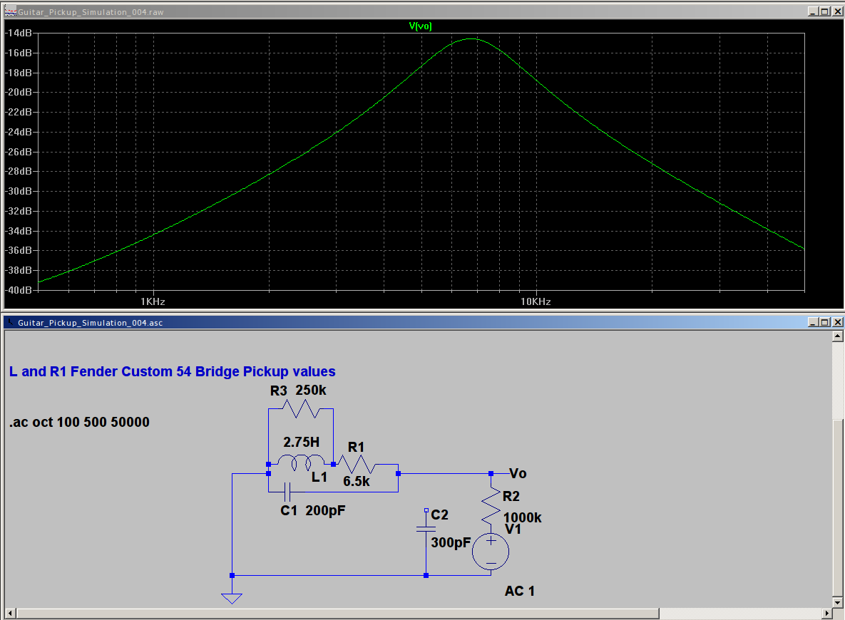

My next question was, what happens to this simple pickup model when subjected to Voltwide's measurement technique, i.e., driving it with an AC current coming from a 1 megohm source resistance.
The screenshot shows the answer. The impedance peaks at the resonance frequency, around 6.5 kHz. No surprises there. This simple electromagnetic model of a pickup reproduces the essential features of the constant-current-drive measurements made on actual pickups, and described in this thread by Voltwide and Peter Pan.

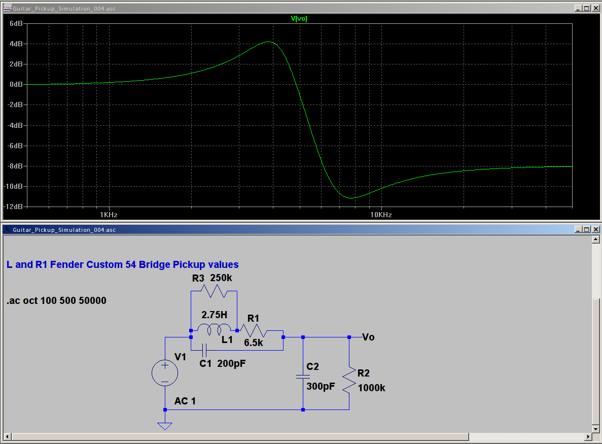

Finally, I added a cable capacitance of 300 pF, in parallel with the 1M resistive load. This is roughly equivalent to a ten-foot / 3 metre guitar cable with 30 pF/foot (100 pF/metre), which seems fairly typical.
And the addition of the parallel capacitance changes everything - not only is there a new resonant frequency at about 4 kHz, but it is accompanied by a +4 dB peak in the frequency response.
There are still traces of the original pickup resonance to be seen - there is still a dip in the pickup's output signal, at around 7.5 kHz this time. It's moved up a little bit in frequency - typical behaviour when you couple two resonances.
For me, things have become both clearer, and, paradoxically, more confusing. I'm pretty sure that the audible differences we hear between pickups is not caused by a subtle 2 dB dip at 6 or 7 kHz, so these results strengthen my belief that the resonance with the cable capacitance is the one that matters (in a passive guitar, no onboard buffer).
But what do we make of the guitar pickup fed straight into a 1M resistive load? There is no peak at all in the response, just a dip instead?
Well, in practice, even a buffer amp has some input capacitance. So I experimented with varying amounts of parallel capacitance.
30 pF wasn't enough to change the results much - still no peak, just a big dip at 7 kHz.
Going up to 100 pF of parallel capacitance was enough to produce a small (1.5 dB) peak at 4.5 kHz.
Based on what I'm seeing in these simulations, I think that some amount of capacitive loading on the pickup is a good thing.
I'm sure that a simple electrical model like this cannot incorporate all the physical subtleties of an actual guitar pickup. But I think we may have enough here to get a good understanding on the basics of how these deceptively simple devices work.

This link from Helmuth Lemme seems to be the one most referred to on this subject:
BuildYourGuitar.com :: The Secrets of Electric Guitar Pickups
Take a look at Fig 2 there, to see the cap going to ground. I had the same thoughts as you about the capacitance being inherent in the coil and how each turn is really its own element and how we are representing it all as a 'lumped' single model. But I think Lemme is right here, because each coil turn, with its bit of R, L and C, also has its own inherent signal generation, and the cap element has to go around that too. The cap needs to be able to shunt some of the signal from the source.
If not, imagine a case where we had the pickup represented by a model, feeding into a very high impedance input. The RLC network, being all in series with the source, would then be all negligible and we would just get a flat voltage output. In practice, the unloaded pickup has its own high resonant frequency.
So, a typical pickup can be represented in the first instance, by RLC as shown by Lemme, and there is a link in his paper to some values. eg, a PAF type might be 3.8H, 7k and 130pF, a low-wind Strat single 2.2H, 5.4k and 80pF etc.
You can put those in a SPICE model, and then add pots, tone cap, cable cap amp load etc and get some very useful results to help inform choices about components in the guitar eg pot values, treble bleed networks etc.
My interest in all of this is to make a spreadsheet that tries to capture all of that in a simple interactive form. I've been picking away at this for several years, my spreadsheet is called GuitarFreak and it can be googled and downloaded via Guitarnuts2.
Going back to the modelling, once that SPICE model is set up (or spreadsheet), as useful as it is, it is apparent that the results still look nothing like an actual frequency response recorded from a real guitar, even setting aside any variation due to the amp. There are several extra effects that apply, which include pickup position, fretting position, plucking position, the relative magnitude of string harmonics, the sensing width of pickups, body resonances and damping.
