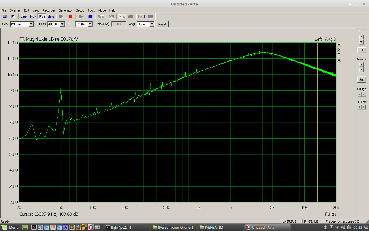

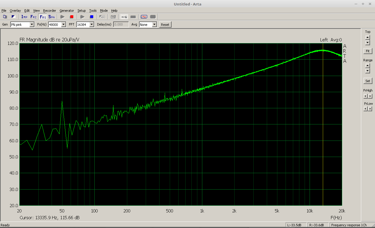

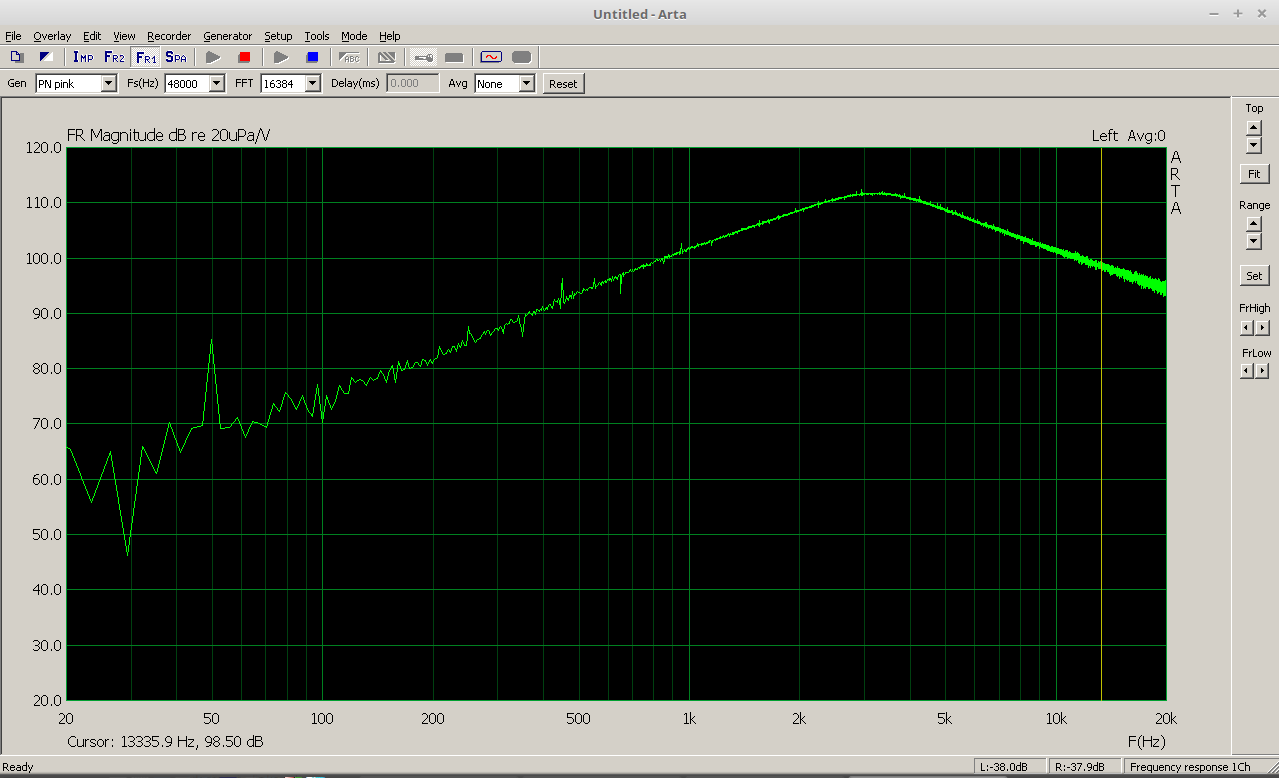

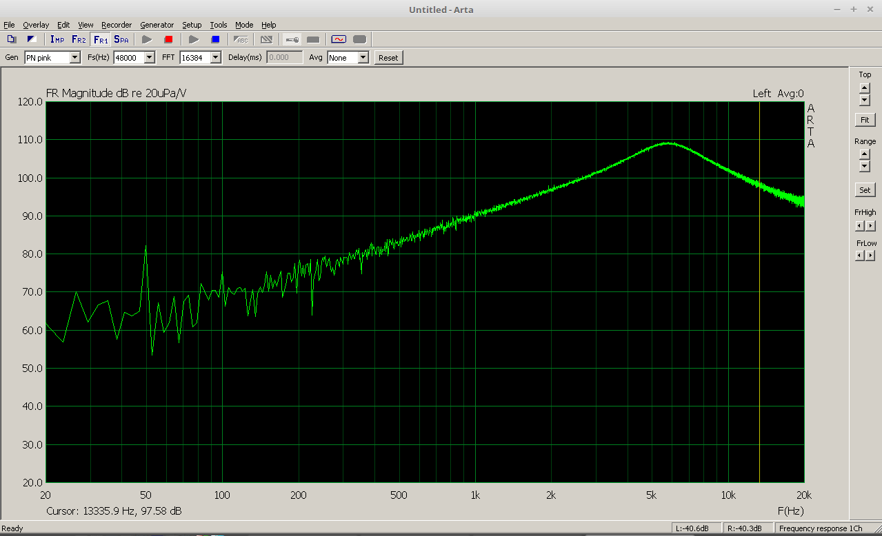

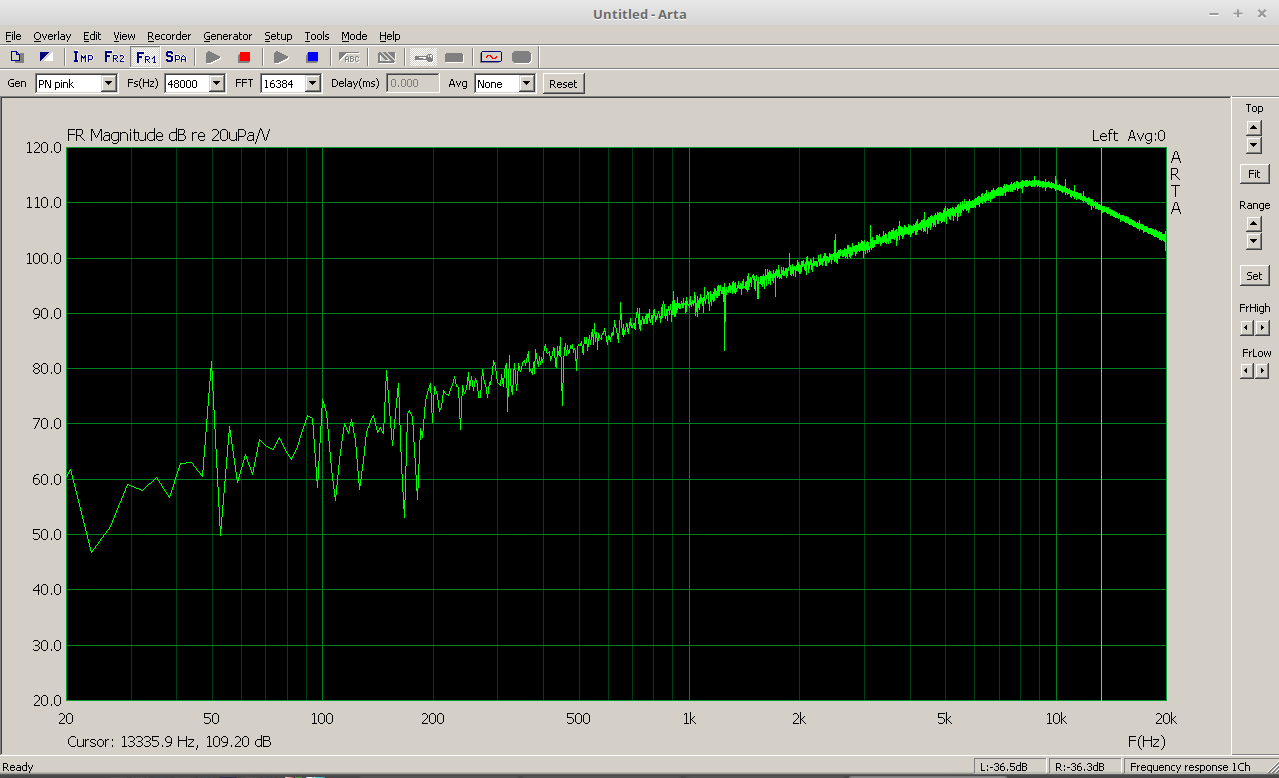

Yes, the wiring alters the resonance peak, normally to a lower frequnency. You can measure the pickup w/o wiring using a PC, soundcard and ARTA for comparision.
I appended some plots made this way in the order
DiMarzio humbucker
Riverhead single coil
Seymor Duncan humbucker
Tesla stacked humbucker
Ultrasonic stacked humbucker
You can see there are big differences of the unloaded pickups

You can use your signal generator and scope. The signal level maybe several Vpp, coupled via 1meg resistor to the hot terminal of your pickup. Measure the level with your scope using a 10:1 probe (10meg input resistance). In that case you pu is damped by about 900kOhm, that is sufficient for the test.
You will find that the pickups with lowest DC-resistance of the coil have lowest inductivity, and thus the peak resonance frequency is the highest. I can say that any pickups with a peak below 3.5khz sound dull to me - I like the crisp fender treble.
ARTA is a (R)eal(T)ime (A)nalyser software you can download for free that works on Linux, Mac and even Win.
I do my measurements simply with the mic input of my Laptop (lenove X201) connected via 1meg series resistor to the hot terminal of pu, and the headphone output is coupled to the same point via another 1meg series resistor. Output volume is set to 100%. And thats all!
For a better noise performance, a source JFET-follower or any buffer amp should be inserted between PU and mic input, saving the noise contribution of 1meg series resistor.
