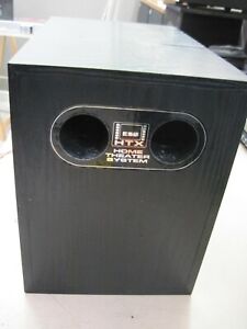

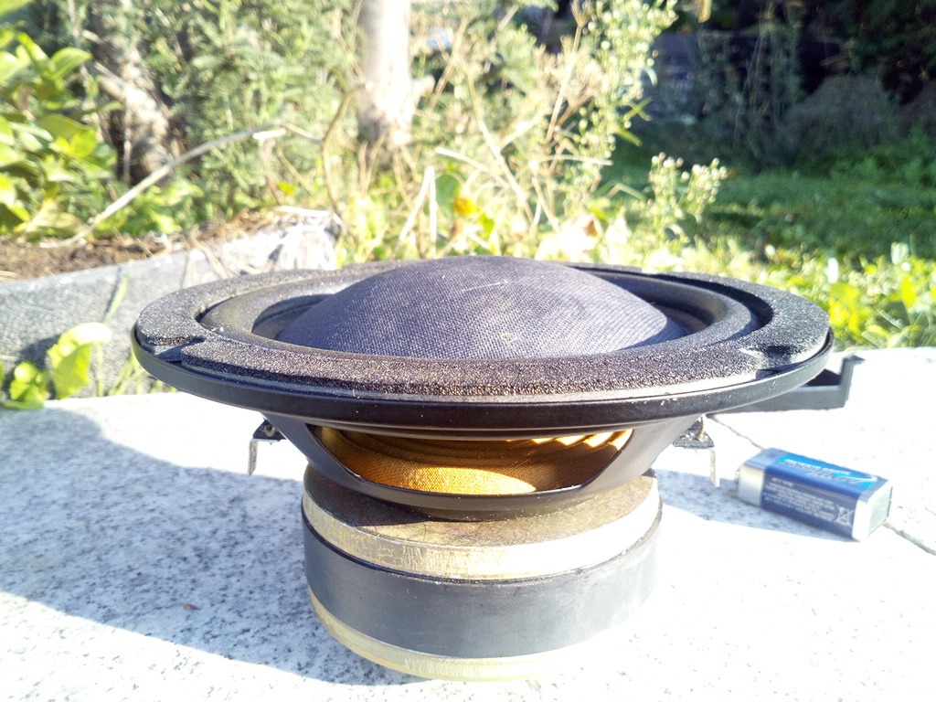

I modified an existing small 6th order Bandpass I got at a flea market with 16cm driver, tuned the reflexes lower, threw the Glas wool damping out, made it active kicking the 12db crossover out, put a big dust cap and refoamed the driver.
Sounded really good with fine impulse response.
Did not expect too much as nothing was measurement assisted!
Listened to radio, o. K. But putting a CD player on showed absolute quality.
