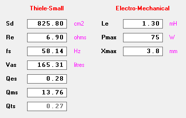

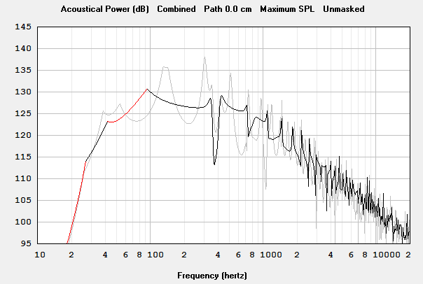

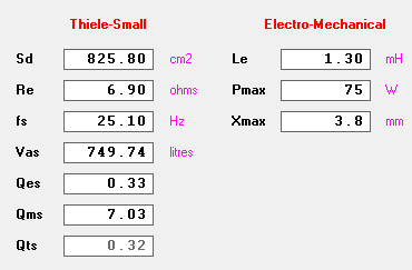

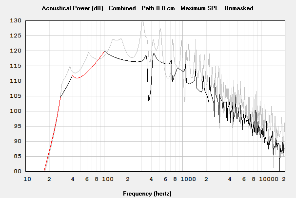

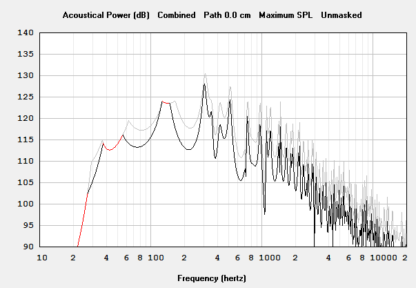

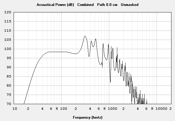

Just a quick comparison to show the basic difference in that the BP6 yields a narrow BW gain down low at the expense of a significant loss higher up.
To get the BP6 to outperform a specific driver's power response in the same size BR box is to use differing driver specs that yields a nominally flat response in the desired BW.
Of course the quickie/unrealistic Altec 416-8B driver spec changes done in HR would need to be 'juggled' to find drivers with a 'close enough' flat alignment, so strictly for educational purposes 😉 and no, did all these 'on the fly', so no text files to Export.
Comparing a BP6 to same BP6 with optimized driver specs.PNG6 KB · Views: 58
