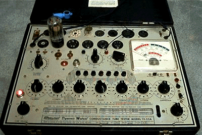

Ah yes, now I recall the model number of one of my starks, it's the 9-66A, with a full set of updates and socket adapters. This is an old tester, but a nice one.
I seem to remember that my other stark is a 12-22 or something to that nature. Same idea but in a black case with newer sockets and features.

Hi Duo,
Do you have a picture of your 12-22? Sounds nice.

I don't have a picture of the one I have, but here's a picture of an identical one I found on the net
I think that should belong to me.
Just keep your eyes open, the 9-66A was given to me by a dear friend.
The 12-22 was going to be thrown out by my highschool, so I took it, along with a lot of other nice things.
Nice! I'm not familiar with that model, but it looks very respectable. Getting a good tube analyzer should be a goal for every tube-head. I've got a Triplett 3444 and a Hickok 752. I will be selling the latter on eBay in a few days, if anyone is interested.
