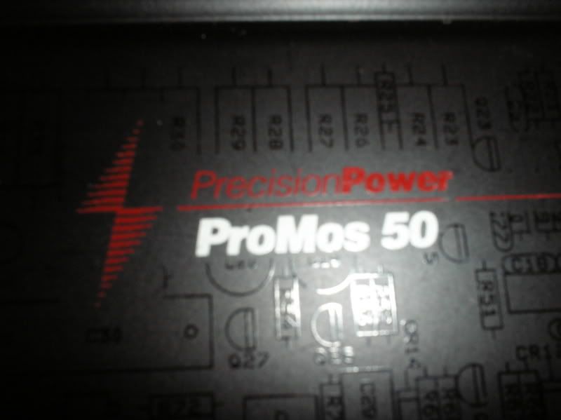

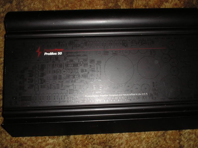

Need to find the actual specs, picture..
Does anyone know where I could get actual specs on this amp? I contacted a person who buys and sells amps on ebay, he sells manuals for ppi as well. (Didn't get my amp from him) Of course he didn't have a manual for the amp I have. He told me he is suspicious of my amp because he says they didn't make any pro mos 50 in the art style housing. Mine is obviously genuine, down to the worn silk screening. Here's a pic from the ebay listing. It actually has all of the schematic silk screening still, just can't see it from this angle:

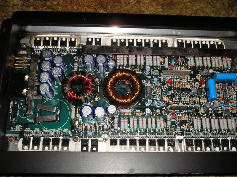

Wow, I just went to ampguts.com and they have pics of pretty much every amp you can think of, inside and out.:bigeyes: The only amp that is the same is the A600.2, it looks exactly the same on the inside as my "pro mos 50" except mine is all black.😕 I am going to go take it out of the car now and take it apart completely. Maybe this one is modded to not protect because I know neither my old A600 or my current A600.2 will run 2ohms mono without making horrible noise and making the low impedance light come on. Maybe I will be able to find out how the low impedance function has been bypassed or modified, I have a feeling its the jumper wire I wrote about previously. Wow, this is weird, the amp appears to be un molested on the outside.

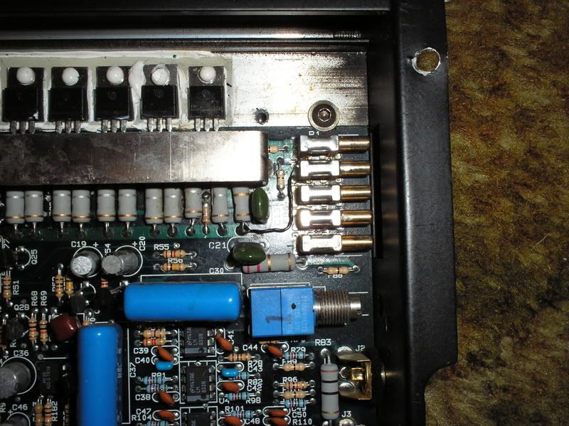

Here are a few pics, the white one is from the amp guts site, it is an a600.2, the last one is after I completely regreased the transistors and under the insulators as well. The wire jumper is just completing a circuit that was previously completed by one of the small 1/8 resistor sized jumpers. It isn't bypassing anything, just goes a different route. You can see it soldered to one of the output terminals, they did a good job. There aren't any shorted transistors or broken traces or cracked solder joints, everything seems to be normal. Maybe I am going to have to run this at 4 ohms mono since the art amps actually drop power output when you run a lower than recommended load. Looks like my next subs will have to be dual 4 ohm voice coils per sub. So basically if this is an a600.2, I have been only getting about 300wrms because of the 2ohm bridged load. :whazzat: No wonder it sounded so much weaker than the phD2.
Well I forgot to check the rail voltage when I had the amp apart:whazzat: but I did check the output voltage on a constant tone/level test cd at work. I had a power supply connected to the car to be sure the battery voltage stayed constant. The maximum continous ac voltage without any audible distortion was between 39 and 40 volts. This was at any load I tried.. 8 ohms bridged, 4 ohms bridged, or even 2 ohms bridged. I'm convinced it is meant to be ran at 2 ohms for maximum output even though it gets pretty hot. I think I'll just mod it for coolant and leave it at that. If it work as well as the last a600 I used coolant with, I will be happy. For some reason today when testing it seemed to have plenty of output unlike the first day I installed it.😕 Maybe pulling it apart, going over the solder joints, and regreasing everything helped. I still have to pull it apart one more time.. I think it has the dreaded staticky noise and I'm hoping its not one of the vertical ceramic boards..:bigeyes:
Almost forgot to ask. On the bottom left corner of my last picture, you can see there are spots for two capacitors, a choke, and a couple of resistors on this amp as well as in my a600.2. What was the point of tracing the board for them if they weren't being installed? There is even a notch on the huge jumper for the electrolytic cap to clear😕

Ok, today I got a chance to check both amps' rail voltages in the car.
A600.2:
test point 1 -38.7 vdc
test point 4 +38.7 vdc
Pro mos 50:
test point 1 -23.2 vdc
test point 4 +23.2 vdc
(the test points were on the output side of the power supply output filter choke. both amps had the same printed numbers)
So apparently the power supply does have lower voltage and it has been modified to run that way. 2 ohms is the optimum bridged mono load, or 1 ohms stereo. That is good to know. But now there is something ELSE I am curious about: Does the pro mos have a built in subsonic filter to prevent excessive power output or to optimize it for spl? I notice its frequency response below say... 30 hz sucks. It seems to go into a cancel out mode like the subs are out of phase at any bass note below approximately 30hz. The earthquake I have will play notes so low you can see the trunk move back and forth slowly. I realize it takes more power to produce super low notes but back when I had an A600 running my two premier 12's bridged into a 4 ohm mono load, it would play every note down to about 20hz. You couldn't HEAR every note, but you could feel it.
