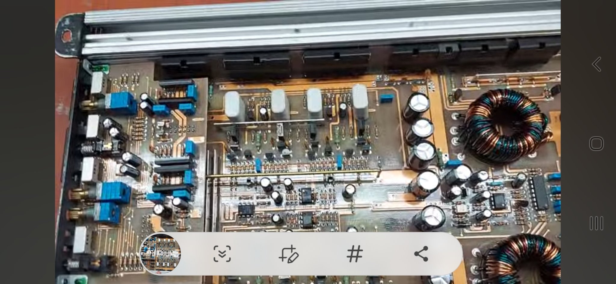

Hello,
I am new to this forum and apologize if I am in the wrong section.
I need help. As the title reads, I have a ppi amp that powers up, appears to be spotless inside, nothing looks burned or smells fried. I got it this way. I know it isn’t anything on my side because I swapped it for my other amp that is identical and works in that vehicle, this one just has no sound.
I am an HVAC Technician but this is beyond my skill.
Any easy fix would be awesome or if you know someone that could fix it for me, I wouldn’t mind paying. I prefer old school amps.
Thanks,
Scott Murphy
I may be wrong but this is what the guts look like

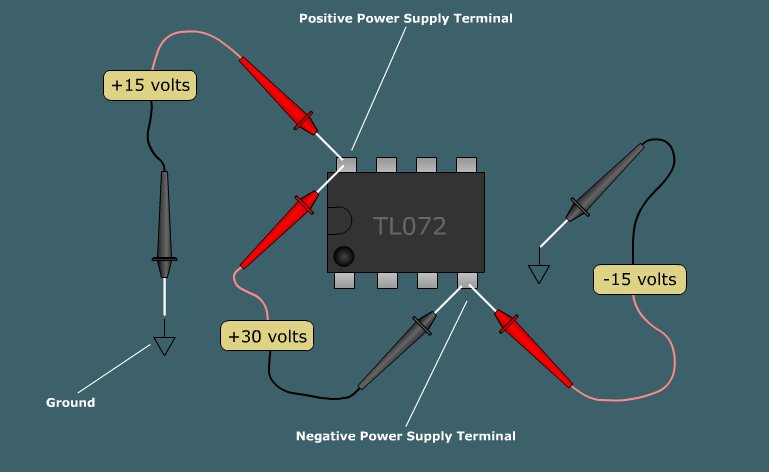

Have you tried operating all of the pots and switches through their entire range with a signal source connected and a speakers connected to the amp to see if it ever produced any sort of sound (even if it was just static/noise)?
If the amp never produced any sounds, measure the DC voltage across pins 4 and 8 of the 8-pin op-amps. What's the voltage?
Just FYI on the clamps.
Yes, I ran through all of the switches and gains and inputs. I have another amp almost identical that works and I installed this amp in its place and tried everything possible and nothing.
I have a meter and I’m an HVAC tech but no nothing about amplifiers or where to check for voltage and what the values would be.

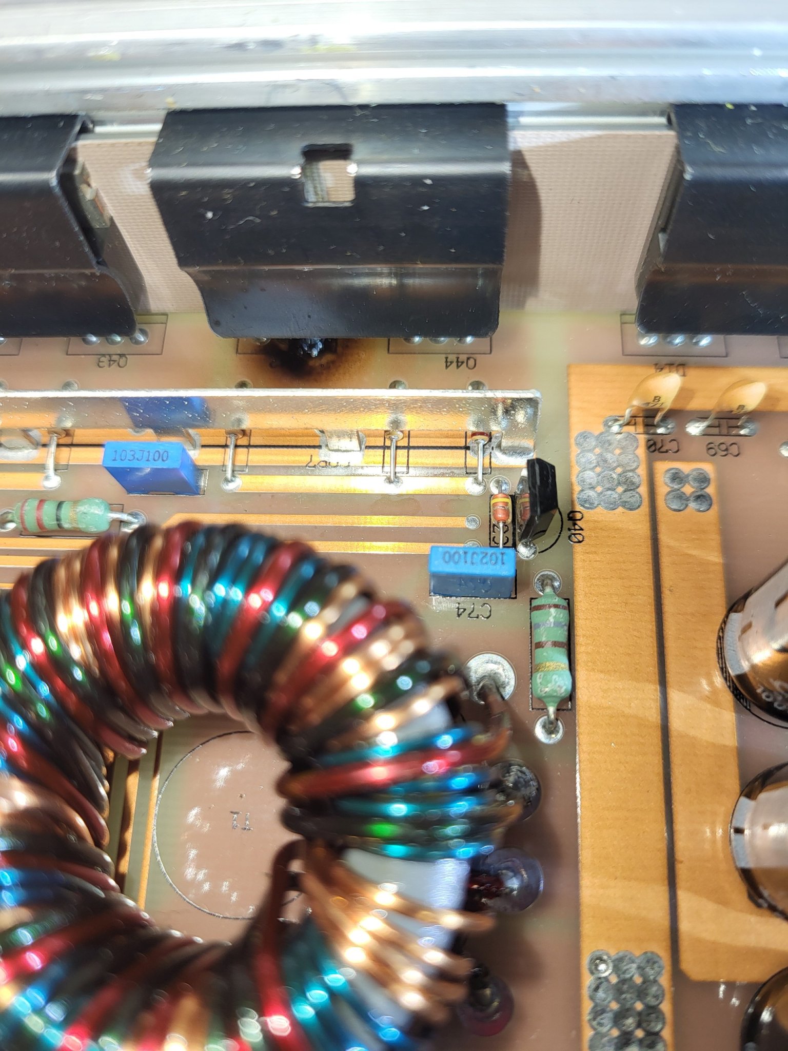

Well that ppi pcx440 finally showed its problem I hooked it up to test never even opened it as soon as I put power to it smoked smelled and smoke came out the power side 😅 so looks like I do need to remove them dam clips 😅
Try cutting that transistor out and then measure the resistance from leg 1 to leg 2 on each of the other power supply FETs. If none read near 0 ohms, you may be able to test further without removing any more parts or clamps. If you do this, the remaining FET that was under the clamp with the blown FET needs to be clamped down before applying power.
I'd recommend current limiting in the B+ line. If nothing else, use a 10 amp ATC type fuse.
The ohm 0.2 even the blown one what's left of it ohms 0.2 on the 2 good legs that 1 other leg is burnt off going to put Clamp on and see if powers up? Using 10 amp fuse for safety so I don't blow what's left…
Well put power to it red light was on for sec and nothing….
Can it run without that one ?
