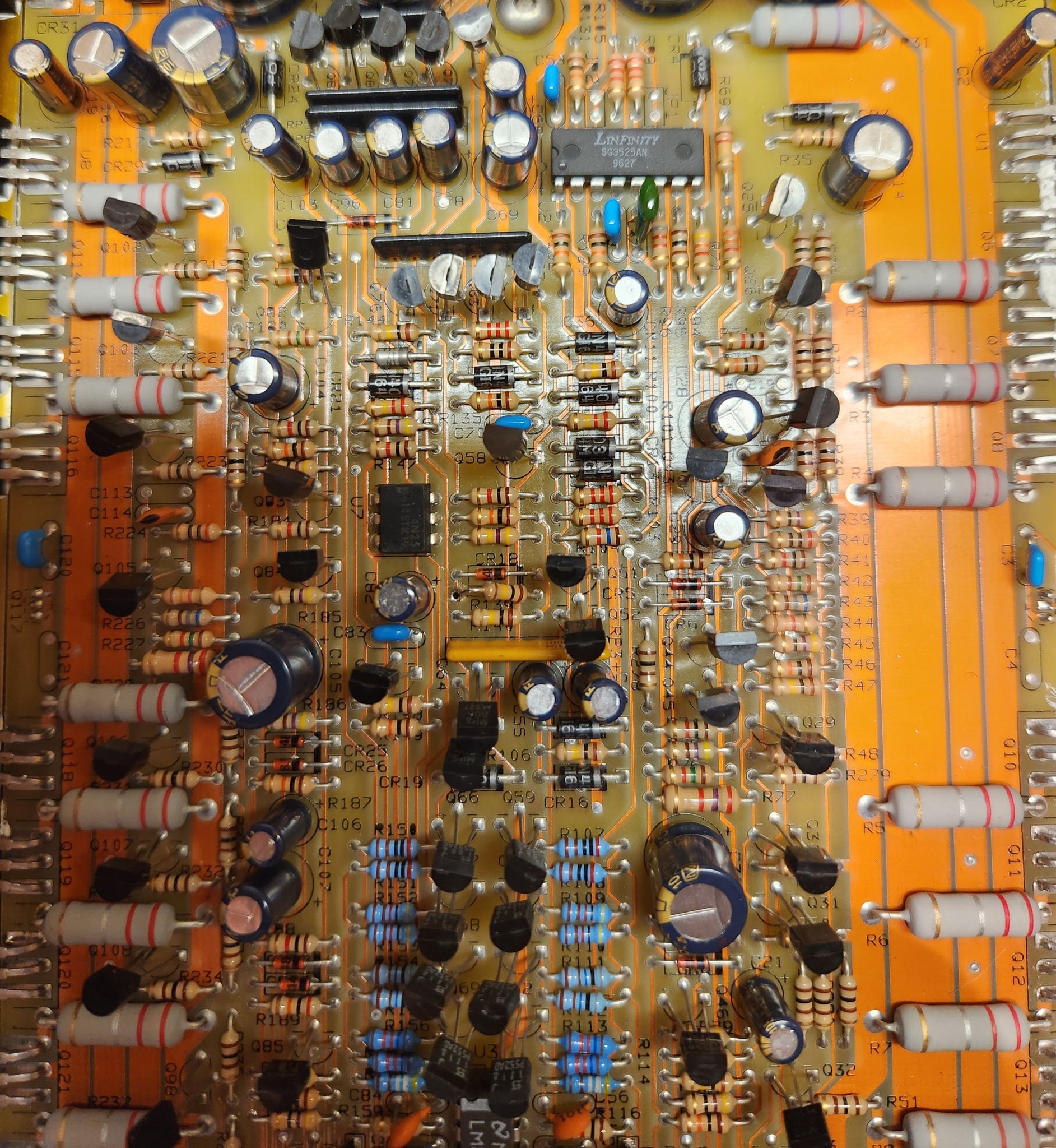

I use the amp on my front midranges and tweeters, and they are very clearly audible from the seating position.
I have measured as much as 1.75V of dc offset at power down which yes, the speakers can handle that but it's indicative of a malfunctioning amp.
It seems like a touch more delay to switching the j108 off would benefit the power on thump, but how to turn them on faster at power down?

There is a resistor between the EF pair that drives the muting circuit and the gates of the j108s. If you remove that resistor to ensure that the jfets are never switched off, does the amp get quiet?
Actually no.
With speakers connected as normal between output and secondary ground it is quiet at power up. There is a slight pop at power down.
When it is connected between the bridging terminals it has a stronger thump at power up, but quiet at power down.
When I shorted the legs on the j108 earlier, I did not have a speaker connected bridged for that test.
Shown in the attached picture I have lifted one leg of R139 lower right of the optocoupler. Gates of all j108's are measuring ~3.5mV.

Did you try shorting both of the bridges channels' jfets?

Re-connecting the resistor and shorting two jfets for a bridging pair of channels did not mute the thump.
SW1 is on the crossover board and is for combining the inputs. Switching it did not seem to change any voltages present on any of those j111's.
On the bottom side there were 330pF capacitors connected to the Drain and Source of the j108s. Switching those to 470pF made no change.
Looking at the schematic for the 6800.2, would increasing the 1uF 50V capacitor near the 4n25 to something like 10uF increase the time before muting is released?

C37? That would delay on and off unless you connected a diode across R107.
Does the power LED go off IMMEDIATELY when you remove the remote voltage?
With R107 out of the circuit and the noise still present, I don't think the jfets are able to mute the audio.

The power LED at power up starts off Red then goes Green in about 1 second. Power down it goes from Green to Red then off a little slower than that with it staying Red longer than Red at start up. At the point where it becomes Red at power down is where the thump is heard.

At thins point, I don't the control of the muting will make a difference if, when there is no voltage on the jfet gates and they're doing all they can to mute the audio, they still don't make the amp quiet.

I agree the noise is happening outside of the jfet's control.
This amp has had all its electrolytic capacitors changed to Panasonic FC, the heatsink compound cleaned and replaced and Kapton tape used for insulator. It has then been on a shelf for eight or so years until about a month ago when I put it into use again. It worked correctly last I remember all those years ago but not now.

What happens if you double the jfets on a channel?

I don't think I have extra j108's, so pull two and just put them leg for leg over another pair to test on that channel?

Yes. Just parallel them.
Can you find a resistor leading into the j108 drain that you could lift to see if the problem is possibly coming in before the 108s?
Parallel J108's make no difference on either of two channels tested.
Lifting the resistors connected to the J108 drain, on the same two channels did reduce the level by quite a bit, to almost tolerable levels.
What is between the preamp board connector (board still out) and the resistor you removed that could introduce the noise?
