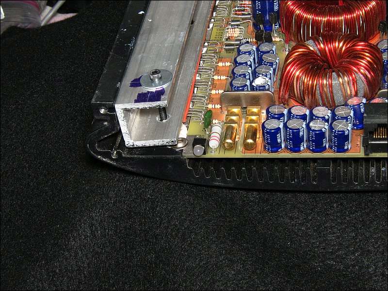

For these amps, the bottom cover clamps the components to the heatsink. If you don't build clamps (see attached), you'll have to watch the temperature of the components very closely. You'll likely have to power up for a few seconds at a time, make a few measurements and then quickly power down.

There's an awful lot of heat sink compound on those TO-220's -- I'd be suspicious of the previous repair attempt just for that. 😉
The measurements of each of the 5 or 6 transistors within one bank should be fairly similar (providing their 'type' is the same -- not a bipolar driver and MOSFET's being driven). Use the Diode range on your multimeter -- trying to measure Ohms is more likely to mislead you (unless they're MOSFET's, which the power supply is very likely to be) -- although dead shorts will turn up just as well either way.
Pics are pretty decent, by the way. But would be better if we could read the device type on the heat-sunk components. Maybe you could mark those up using PBrush or similar.
You'll also want to check that the 'replacement' devices aren't thicker than the originals. The single clamp approach works great if all the parts are on Sil-pads and within a few thousandths of the same thickness. If you're using mica insulators, the thickness of the individual parts must be much more closely matched. (Somebody much smarter than me can probably tell you how closely . .)
