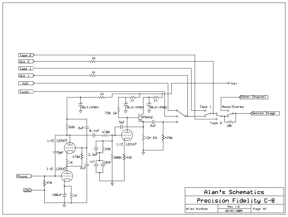

Look! The C8 schematic!
Well here it is! I did say I was going to draw it and hey, it wasn't too hard but took a while.
Note, I did not draw the power supply because there is another one that I would use if you plan to build this preamp, and it is basically the same design.
This is the first stage (Phono) so enjoy!

C7 for C8?
I always search for a schematic of this preamp but can only find the one on that site that everyone disagrees with.... I don't understand it looks like it would work just fine, the concept is strange but will it work right if I built it from scratch?
It is rather frustrating that everyone complains and brags about this preamp yet no one tries to make a revised rebuild. :worried:
I completely rebuilt the C8 from scratch, I think I used the power supply from the C4 .... worked just as well and I slapped the regulators down to a massive heat sink solving the heat failure problem but changed the sound in my opinion.
I will make a bargan with someone, if they are willing to send me the true revised version of the C7 (does not need to include the power supply as I can make my own), I will send them all of the C8 schematics along with pictures and parts info. :cheers:
I am building an all out preamp and want to use the best RIAA stage I can find and the C7 stands out from all others. :up:
