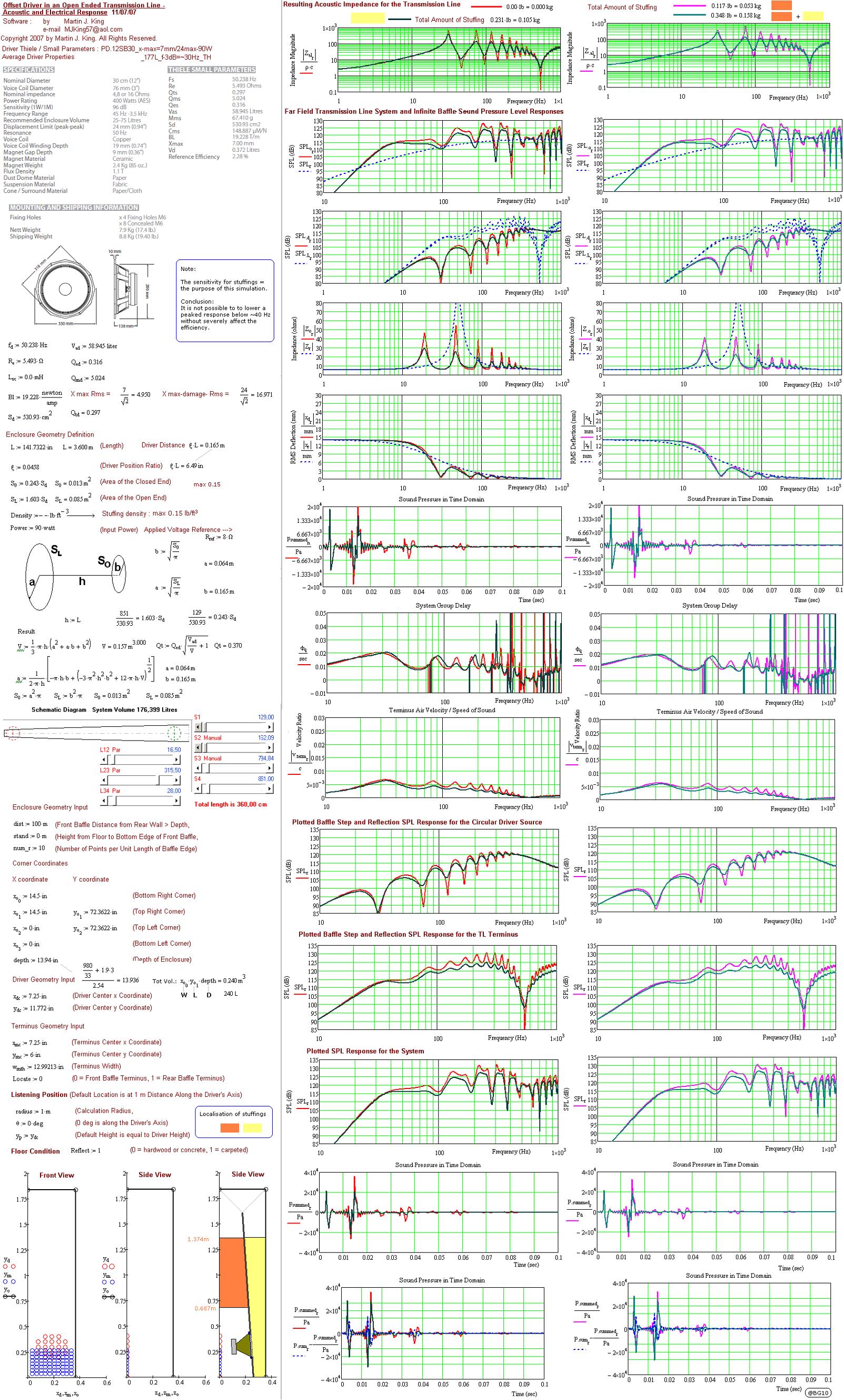

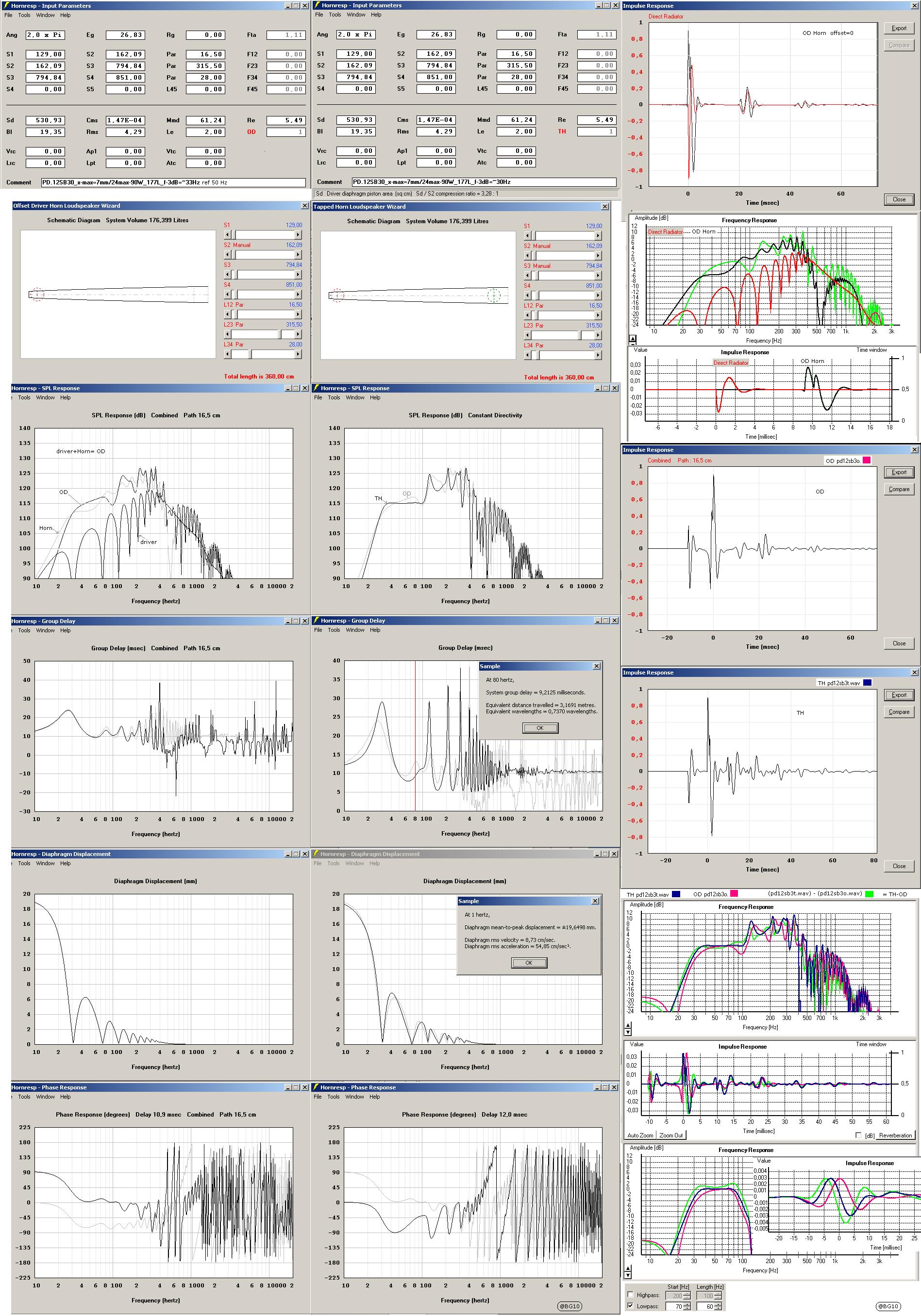

PD.12SB30 Home TH
I like the look of THIS driver also with it being a good price, high effeciency and fits what i want from it I wandered if there's any reasons whby i shouldn't use pro drovers for hifi.
Boscoe
Hi, I noticed this driver a while ago and made some simulations, i.e. a 30 Hz/115dB into half space TH: At 90W and below no HP filtering is needed ...FYI:
