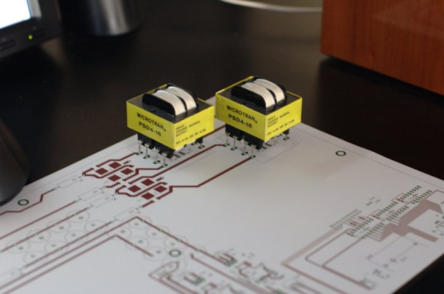

I finished designing the power supplies (thanks to the recent threads on shunt regulators). Here's the PDF, and the BOM has been updated.

Been working on this layout for months. Hard to see what's going on in a PDF, since it's a six-layer board, but here it is anyway, for the curious.

That transformer I specified is useless. Digi-key says it's 16VAC in parallel, but it's not. It's 16VAC on one secondary, and 35VAC on the other. The correct transformer is Tamura 3FD-416. Sorry for the error.
Here are the manufacturing images for the board, in a 1MB PDF file. The pages, in order, are the outline, the silkscreen, the top solder mask, metal layers 1 through 6, and the bottom solder mask.

I had 10 boards made, although I only plan to build two units myself. I will sell the boards to forum members for the low, low, insanely low price of $125, shipped in the USA or Canada, if anyone is interested. That's my cost. Anyway I'll post it over on the market forum later after I prove that the boards are error-free.
One design note: I found that you can't allow the -9V regulator to operate when the +9V regulator is disabled. The CS3318 draws infinite current in this state. Luckily my negative shunt regulators are inherently limited to 200mA of current, so I don't think the chips were damaged or destroyed in my testing.
The good news is all four regulators work great, and nothing smokes when the unit is powered on.
The only real construction difficulty was mounting those Jensen transformers. Their #30 stranded leads are very difficult to strip properly, and sticking a #30 stranded wire in a #30 drill hole is painful.

First clear pic of my baby. Power supplies working great. Need to write software now.
