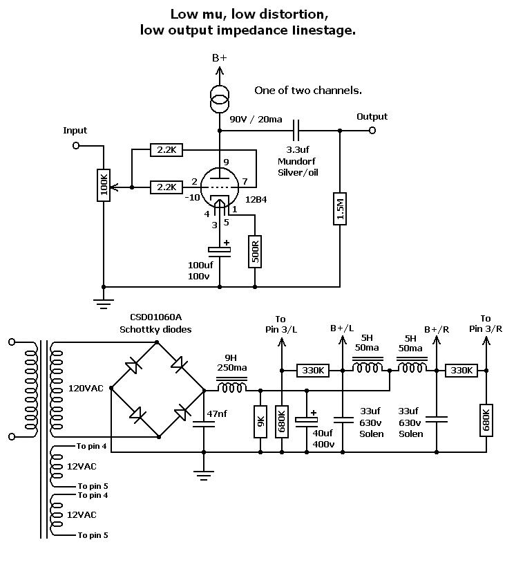

I AGREE with the 12B4 idea. The low mu seals the deal. I'm attaching a schematic for your consideration. Ditch the PSU shown, but the signal circuitry will serve you well.
Voltage double the 6.3 VAC winding of your power trafo with a pair of Schottky diodes. Use 2X 10000 muF. 'lytics in the doubler stack. Feed the resulting DC into well heatsinked (1 per 12B4) 7812 3 terminal regulator ICs.
That 1 A./14 VAC winding can, with the addition of a small series resistance be used to power the heater of a Locktal based 14Y4 rectifier. Hold the value of the 1st filter cap. down, as you have more Volts than are necessary. A gyrator is a good substitute for a choke and has (in this case) the added benefit of dropping a few of the extra Volts.
Oh yeah, since you are using a motorized volume control, eliminate the 100 KOhm pots. and install 1 MegOhm safety grid leak resistors.

TS,
The pseudo choke I/P filter shown has the "fudge factor" cap. (initially 47 nF.) tweaked at the bench to make the B+ rail voltage, under load, come in at 120 V. 30 V. is enough compliance for a Bottlehead C4S. Why make the "sand" work hard and get hot?
I suggested a LOW cost 14Y4 to keep the rectifier's heater supply separate from the signal tubes' DC heater supply. A 12X4 will do, but the 14Y4 is dirt cheap. Heck, the Locktal socket costs more than the tube.
