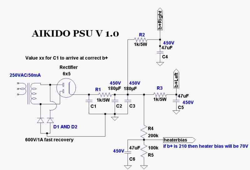

Looking at the Aikido scheme, I have one more question: Is it OK to run TWO tubes from the same B+ supply capacitator? Is it better to have for EACH tube its own ps RC filter?

Try this PSU

My last question is about power supply. I will post schematics of my PS design later today. Anyway is it better to have big supply caps or smaller one? How can I know if the value of capacitor is big enough or when it is big TOO much.

The psu is ok., but I suggest al small change;
start with 47 uF after the rectifiers, then the first 220 uF after the choke, also 220 uF after the resistor with a good quality MKP or paper/oil (1 to 4,7uF) parallel to this last cap.

Why 47uF first ad the 440uF after choke? What is advantage of this compared to my posted design?
I will parallel with some foil definately, I just didnt draw it in the scheme.
I can get ECC99 no problem, but my PT will not handle it. ECC99 has 5W max Pa. I will have roughly 150V on plates, so for 4W tube will need 26mA, double that is 52mA and for two ECC88 is 16mA. Maybe bias ECC99 little colder, but the preamp is not mentioned to be used as headphone amp, anyway I just have very low impedance headphones (cca 100 Ohm).

My expierience is, if you use a relatively high value capacitor for the choke, during turning on and off you get a lot of overshoot, swinging en momentarily oscillation at the power supply output.
Just mostly for a short time, but still long enough......
Choosing a cap, what is smaller than the cap after the choke, the chance of an unstable psu is almost zero!!
When you use a relatively big choke and big capacitors, the choke and second cap are responsible for a smooth and ripple free output voltage.
A nice idea is to download the power supply designer on the page of Ducan's amps.
This gives you a big help todesign and simulate a diy power supply.
