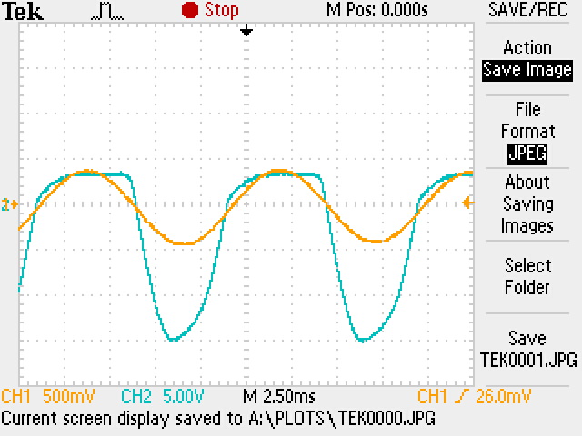

I prodded around with a scope to see if I could find the issue. I think I did. See attached image.
I used a signal generator set to ~95Hz. That's roughly a low F# (2nd Fret low E string) because I would always hear the problematic sound really well on that note. I set it to 1V peak-peak which is roughly the output of my SG.
What you're looking at: CH1 (orage signal) is the input from the guitar as measured on pin 2 of V1. This is the 1Vp-p from the signal generator. CH2 (blue signal) is the signal going into pin 2 of V2. So it represent the change in signal due to the second gain stage which is the second half of V1.
I have the gain cranked and as you can see the top half of the signal is clamped at 5V while the bottom half goes to -15V. (Notice that the volts per division is different for the different channels. 5V per division for CH2. 500mv per division for CH1.)
The gain stage in question is the second half of a 12ax7 and it's plate resistor is 100K and cathod is 2.7k with a plate voltage of 225V.

Any ideas why this would go so asymmetrical? It's like that tube isn't conducting equally across the whole range of operation but I know it's not the tube.

The asymetrical clipping is actually what is to be expected with valve amps.
When the grid gets positive wrt the cathode, it starts to conduct current.
Since the preceding gain stage can't supply much current, the signal clips, but only on the positive swing. Soft clipping on one side translates as 2nd harmonic.
Swinging more negative does nothing in terms of grid current, so no clipping there. The triode is driven into cutoff, so you will see clipping on the anode (phase inverted, so on the positive swing where the anode cannot go higher than the supply voltage).

I was aware that valve amps have asymmetrical clipping but I didn't know it was this drastic. I checked the plate voltage of V1b, V2a, and V2b and then checked the signal level after the coupling caps for each one. Adding the positive magnitude of the signal to the plate voltage resulted in the B+ voltage for that stage so it is truly going as high as it can. This likely means its behaving appropriately in this respect. But I still didn't expect it to go so low. In some cases the magnitude of the lower half of the signal is large multiples of the upper. 3 to 1, 4 to 1, etc.. Is this much asymmetry expected?
Further, this still leaves the terrible sound. Any tips on how to track down an undesirable sound by looking at the signal?
Overall symmetry vs. asymmetry is mostly about bias points and relative signal levels. Compentent amp designers are well aware of shaping this clipping characteristic by varying bias points or overall signal levels within the gain stages. "Gain staging" as it's called...
Take a generic common cathode amplifier gain stage. You can bias it so that its plate is about 1/2 of B+, which provides equal headroom for voltage swing in both negative and positive halfwaves. Or you can bias the stage so that plate voltage is either closer to B+ or closer to zero, which increases headroom of voltage swing on one halfwave while decreasing it on the other. The further the bias shifts from "center" the more prominent the asymmetry becomes. Most tube gain stages are deliberately biased for asymmetric headroom, therefore also asymmetric clipping distortion. As said, symmetric clipping is largely just a matter of rebias.
Then there's aforementioned clipping due grid conduction. It's caused by too high grid vs. cathode voltage difference so whether it gets designed in or not is largely an issue of tube bias (again) and signal levels hitting the grid. Again totally avoidable by design but often on the contrary "designed" in to enhance asymmetric characteristics. Competent amp designers are well aware that they can shape grid clipping characteristics, not only by varying source impedance and current amplifying capability of the driving stage, but also by choosing something between capacitively bypassed cathodes with low Rk's vs. non-bypassed cathodes with higher Rk's. If you look at high gain guitar preamp designs you often see that there's a lot going on in this regard.
Naturally, the more you overdrive the gain stages or grids (or wherever clipping happens) the more pronounced the symmetry vs. asymmetry gets. This characteristic is of course largely a matter of establishing the preferred overall signal levels within various stages of the circuit.
The only means in which asymmetry is inherent to tubes can be observed from the characteristic curves, which often portray different knee characteristics in transition regions to cutoff or saturation. One tends to be soft transition, the other is hard.
Wow, teemuk. That was a great explanation. Looking at the B+ vs bias points of each of these, it's pretty clear that there will have to be asymmetry once you start bringing the gain in because it's biased much closer to B+ than zero. Thanks. I'm starting to explore other possibilities with this amp.
