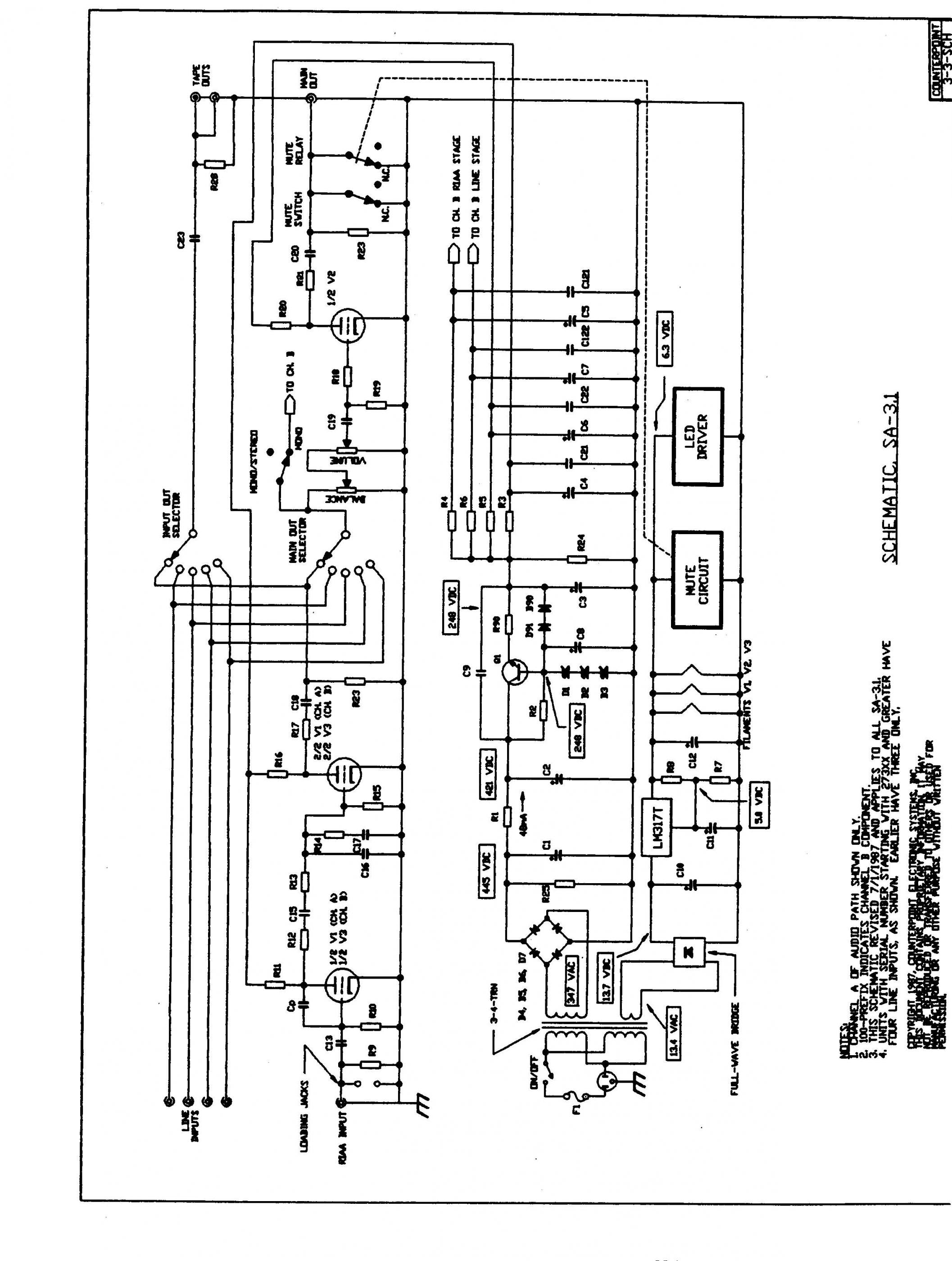

Have you got grid stop resistors on all tubes?
Circuit diagram?
Schematic

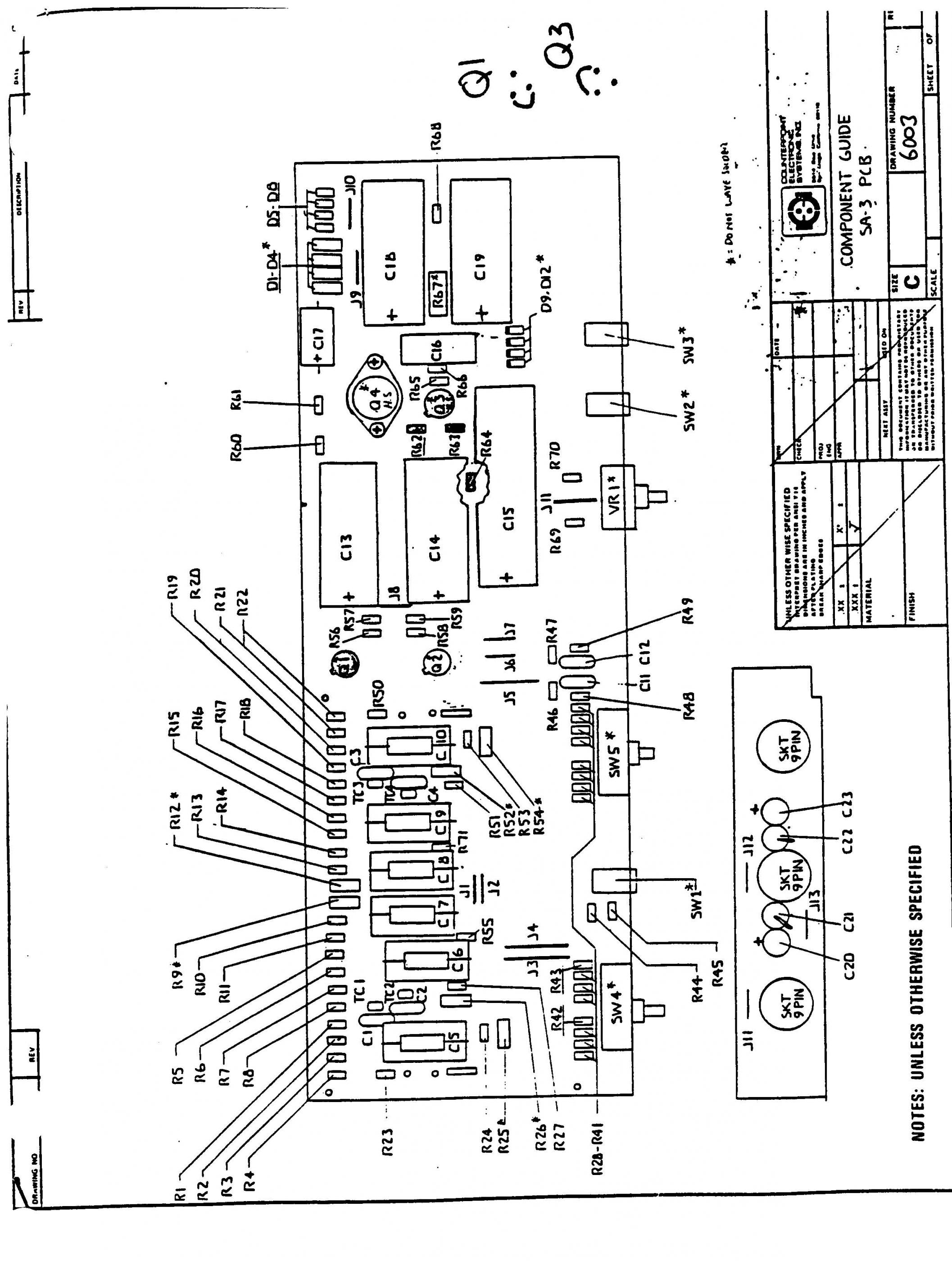

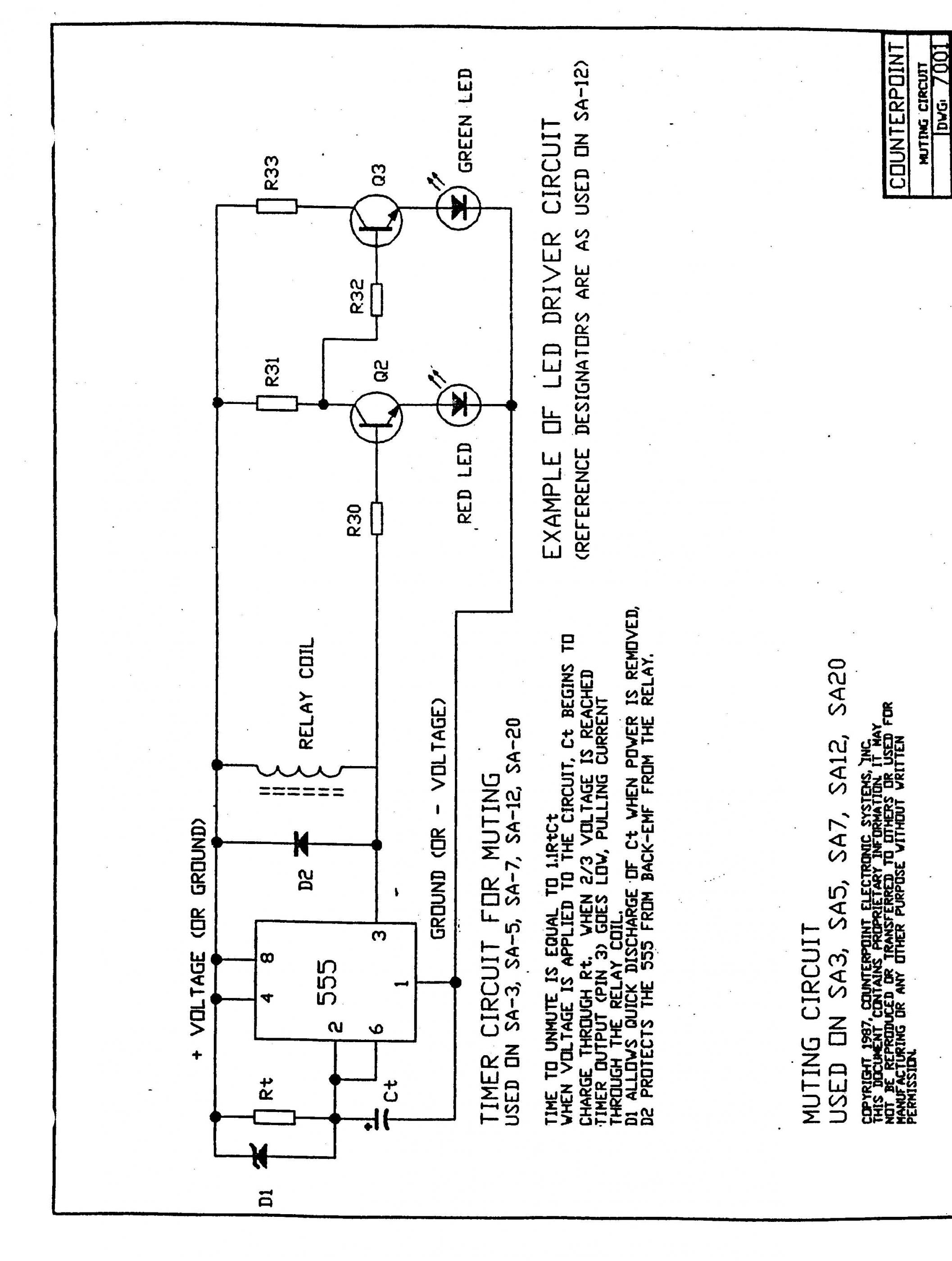

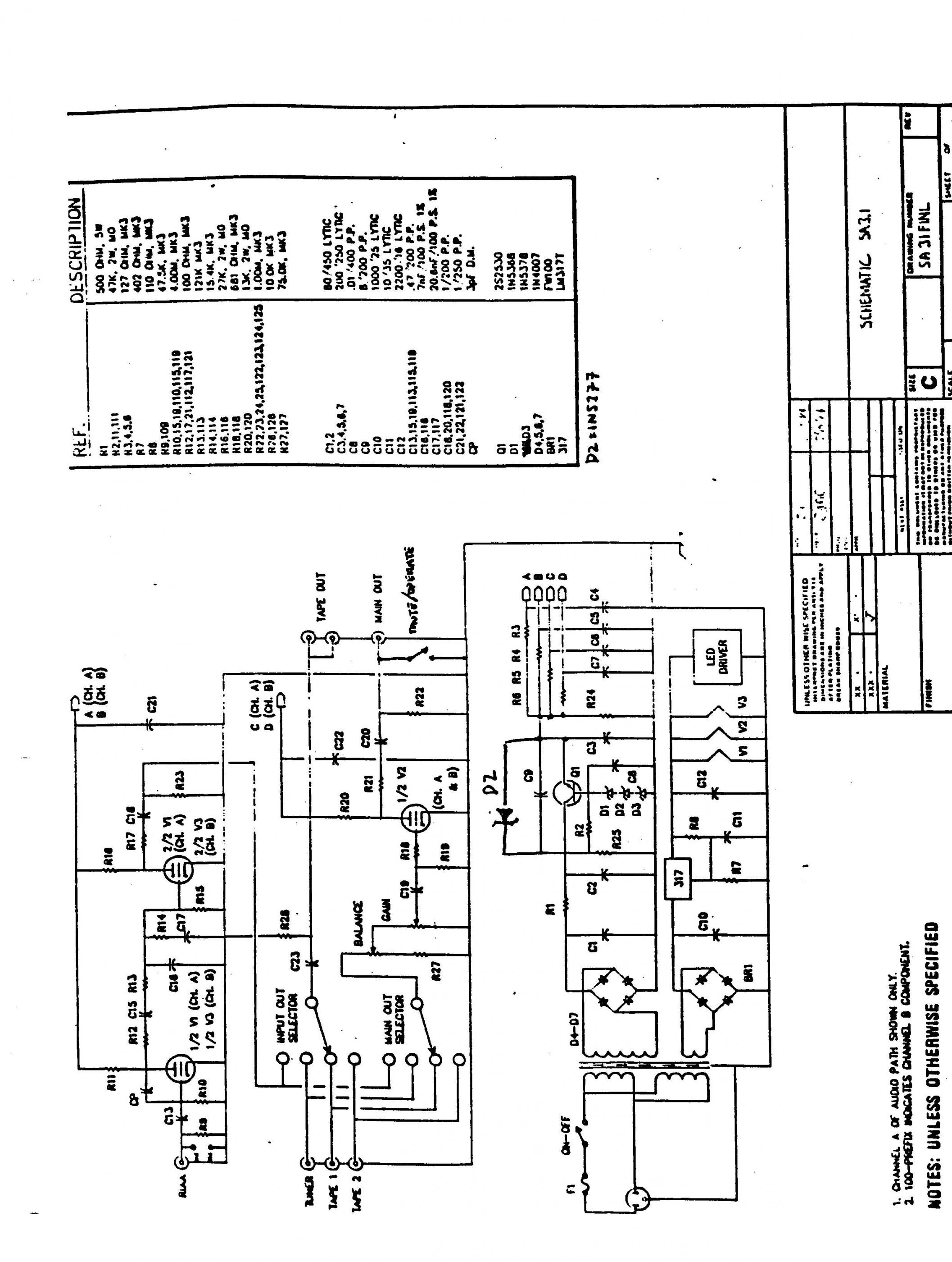

Grid stop resistors? I can find components on a schematic, but I still don't know terms. I'm attaching the schematic. Can you tell me which ar the grid stop resistors? Are they the ones between the grid and ground?

I'll be looking at that grid stop resister tonight, R18, but beyond that I got nothin'. There are so many different versions of these things out there that most of my actual circuit doesn't match the schematic, and I can't tell if it's an aftermarket mod or just a different configuration from the factory. I've found pics of the circuit boards in these preamps and every one is different! Oy.
