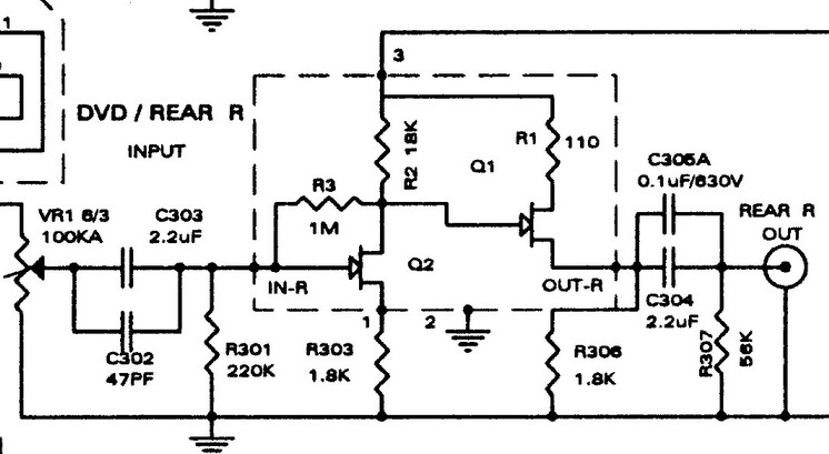

Recently a very kind gentleman sent me the circuit of a cheap ($1000) Audio Refinement (YBA) 6-channel pre. Amazingly, all the channels follow identical, tube-borrowed topology and the entire pre is powered by non-regulated but heavily filtered PS. It also seems to sound decent. I do not in any way claim this to be a great topology but find it interesting that contemporary commercial designs like this exist.
analog_sa said:
Hi Beppe61
I am beginning to appreciate your sense of humour.
Dear Analog_sa,
Thank you very much for your kind words.
I swear I tried to learn some basic electronics on the books.
But I failed miserably.
Thank you immensely for your schema.
This is exactly what I am looking for. I would like to express my humble considerations hereafter. Please correct me if I am wrong.
1) At present it doesn't seem possible to assess the sound quality of a circuit only on the basis of a set of measurements.
2) The mere fact that a topology is old doesn't mean that is also bad. Just look at tube amps and preamps.
3) I think simple is beautiful. Very few components used in their best working conditions to achieve the maximum intrinsic linearity.
In a line preamp (my present nightmare), for instance, two active opportunely selected devices can be enough. One for the voltage gain and one for buffering.
4) A lot of highly regarded contemporary designers have changed to topologies with a minimum of feedback or with no-feedback at all.
5) Yes. In a buffer the feedback is 100%. But they are needed to get current and low impedance. So buffers are convenient and pretty much inevitable.
6) The quality of power supply is enourmous. For instance a well executed batteries based power supply can elevate a very good preamp to a stratospheric level.
7) If the damages to the signal is done at low level, then you can only amplify them. I must say that in my experience I found a lot easier to find nice power amps then nice preamps, especially in the solid state field.
8) A lot of people are worried of coupling caps. I am much more worried about quality of caps. Film and electrolytic.
Now, if only that very kind gentleman could disclose to us the kind of fets used and the value of voltage supply.
May be I am too demanding here.
Anyway those are the topologies I am looking for.
Simple and nice.
I am looking forward to hearing from you and everyone else who wants to enter in the discussion.
Thank you very much again for your valuable suggestions.
Kind regards,
beppe61

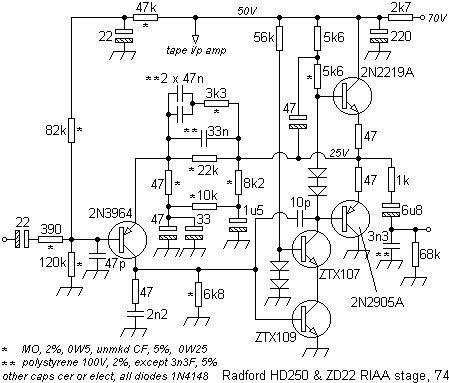

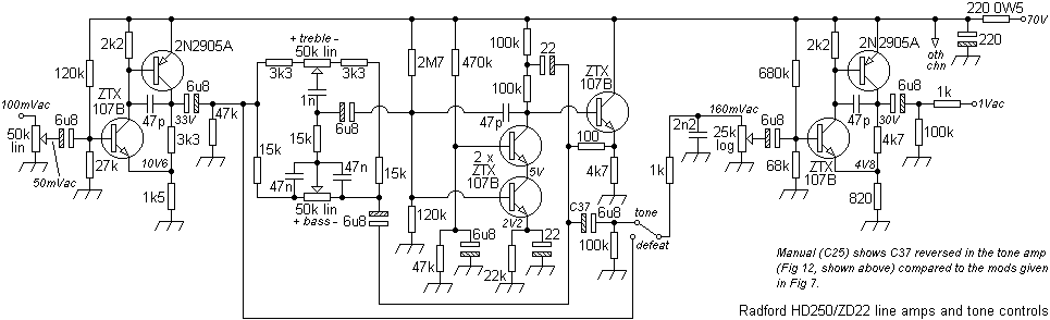

Hi beppe61.
I've been playing around with this circuit topology for about 6 months now. I'm only using a 22V rail though. The linearity is good so i don't see the need for a higher rail, 2V RMS out will drive any power amp i have to full power and i can get 5V RMS with less than 0.1% DHT. At 22V it is easy to keep the power dissapation down.
Things I've found important.
1) to keep distortion low at high frequencies it is best to ommit C26
Chris
Hello
I presume that the high value of C26 do reduce the slew-rate of the circuit ?
But is C26 are there for stability purpose, how about reduce it to 27pf ?

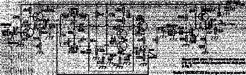

Btw, here is the complete Radford ZD22 preamp circuit.
Thank you
Bye
Gaetan
