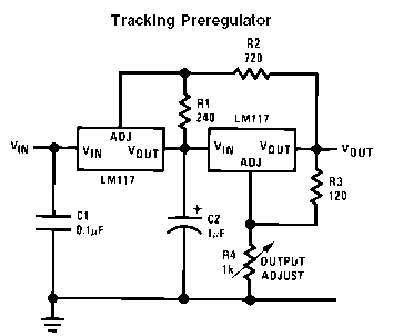

Double regulation.
You can use double regulation, with the 78xx and 79xx .
That is, use 7818 and 7918 first and then 7815 and 7915.
Before the first regulators I would use 3300 uf, 1000 uf sounds weak to me.
After the regulators, something like 100 uf is fine.
Always bypass with 100 nf ceramic caps.
It's a simpler design than the LM317/LM337, but the LMs are better.

I think that Andy's suggestion for a pre-regulator is a good one. Another worthwhile direction to pursue is constant-current operation, which can be implemented in a variety of ways. This would include folded cascode main circuits (with constant-current sources), shunt / super-shunt regulators, and some types of push-pull regulators.
In my experience, a major benefit of constant-current operation is that it tends to reduce the sonic differences caused by componentry choices in the power supplies.
hth, jonathan carr
