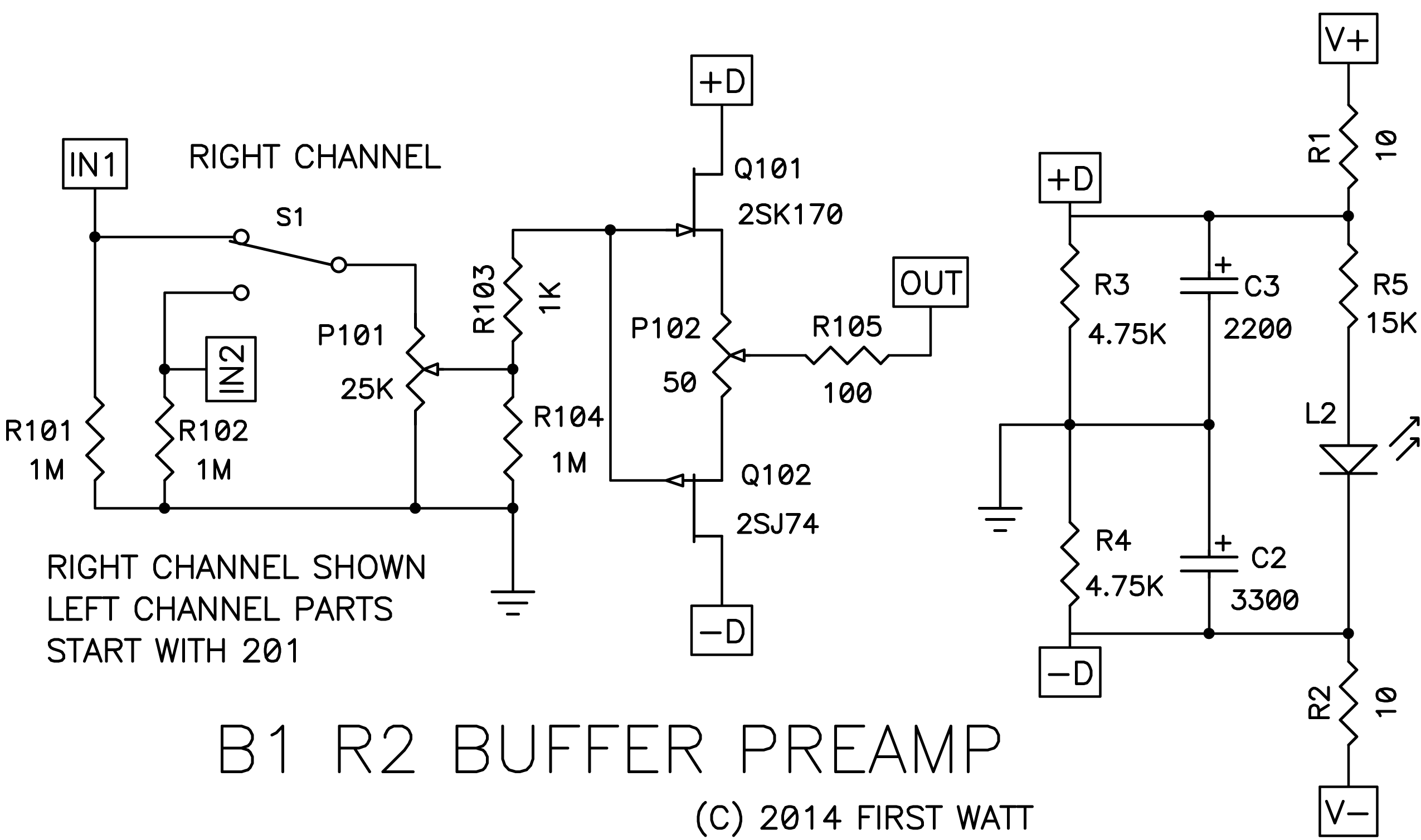

Been lurking on the forum and doing some builds for a couple of years. I have built a B1 (no korg) and a pair of ACA amps. I am currently looking to upgrade my preamp and am struggling to find good comparisons between the B3, B1 Korg, and wayne's linestage and the ACP+. I like the idea of a headphone amp too, so the ACP+ and/or a wayne's linestage with Whammy sound intriguing. Reading between the lines it sounds as if the very best would be the wayne's linestage and a whammy. How does that compare to an ACP+? How does the ACP+ compare to my B1? I realize it is my ears that are the final judge, but would be curious what other people think. I am currently using a pretty good class D amp (250W a channel, Red Dragon) and some Spendor speakers. i have also kicked around the idea of getting an old Threshold PRE (SL10) and recapping it. My mind is running around in circles.....thank you for your help.

The B1 is very neutral and accurate. Almost perfect, but no gain.
If you need gain, but no color, The BA3 or Wayne's would both be good choices.
If you are looking for a bit of color, The Krog B1 or the ACP+ would be the 2 to look at.

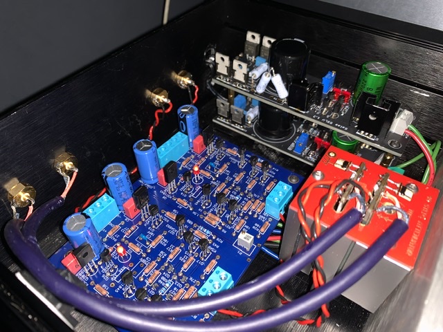

For the preamp swapping, having a regulated, bipolar supply that offers some adjustment is ideal. I use the Salas UltraBIB, but there are many great options. I’ll try and post some pictures of my setup later.

Et, here’s a quick pic of my preamp box. I was limited on space and stacked the UltraBIB (top is positive rail, bottom is negative). I use two ac/ac wall warts to get the correct AC voltage to the regs. Obviously with a bigger enclosure you could include a transformer in the box. You could also build yourself a dedicated external PSU, then use it to power whichever pre you want. Many ways to do it - just comes down to your preferences.
If you want to really embrace the modular approach, check out the Yarra.
