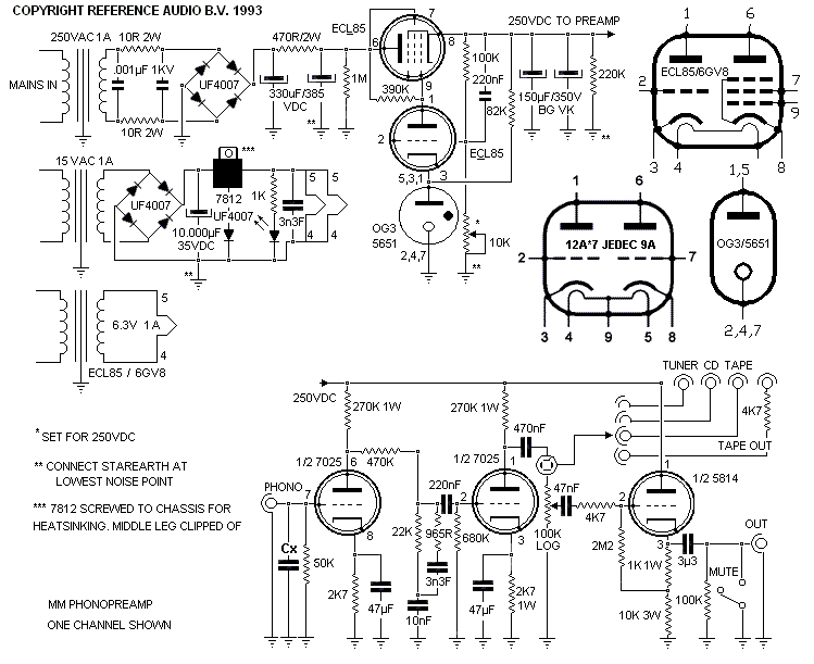

Greetings,
I've run into a problem building the 12v filament supply in the attached
drawing. I couldn't find 15v trans. so I got a couple of 14v hammonds.
The problem is the reg. drops the voltage from 14 to about 10.6v.
How do I bump the voltage up to 12.6v.
Brian
Can you check the DC voltage at the input of the 7812 regulator IC? I believe it should be somewhere around 18Vdc. It should provide sufficient volt for the 7812. If the transformer is with CT configuration, you may use 2 diodes for the full wave rectification. This will lower the volt drop across the rectifier circuit.
The total filament current draw should be 0.475A that the 7812 should able to handle.
Johnny
The 7812 regulator needs at least 14 volts input to work. With the diode in the ground leg it will want 15. Check the voltage at the input to the regulator, if it is slightly low you can pick up an additional .5 to .8 volts by switching to Schottky rectifiers, they have a lower voltage drop, and are usually quieter.
If that doesn't provide enough voltage, use a low dropout voltage regulator instead of the 7812. The previously mentioned National Semiconductor part is a good option. I use the LM2941, adjustable regulator, but it has 5 pins which makes hand wiring dificult
The voltage before the regulator is about 14.6. After it drops to 10.6.
I tried removing the regulator altogether and added a 8ohm resistor
and that gave me 12.6 exactly but I am worried that I'm deviating too
far from the original design and I'll suffer noise on the phono and line
stage.
I tried a couple of 1n4004's to the ground leg but that only raised a few tenths of volts.
I'll look for LM294X at mouser.
Brian
The 8 ohm resistor is not a bad idea, especially if a reasonably large capacitor is added to ground after the resistor. A resistor in series with the tube heaters limits the inrush current, and promotes longer filament life. I would leave it there, and finish the preamp. Then you can listen for noise.

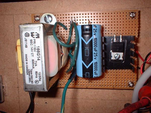

Ok let's see the trannies are 166g14 .5a I tested the caps and they seem to be good.
Here's a photo maybe someone can spot something I'm missing.
I''m thinking of completly dissassembling the 12v supply and trying more breadboarding. I'm have a sneaking suspicion that I'm missing something simple.
Brian
