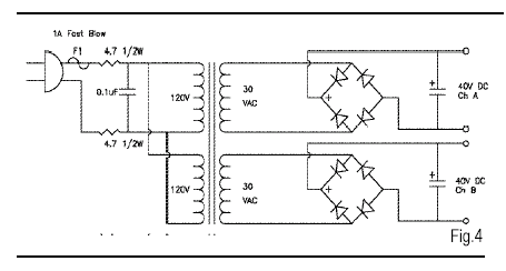

Ok guys, I got the idea of using the R's in-line with the AC from the Pass Labs Pearl Phono that I just finished. See attachement, it uses a 4.7 ohmer in each AC leg, and I'm just using one and making it bigger, no?
I'm not worried about saftey as it is well insulated from prying fingers.
Come to think of it, I forgot that the regulator board has a set of 1000 uF caps on the front end input so it would be easy to mod this thing for a CRC supply to feed the regulator. I'd use C=4400 (bridge board) R = 200 and C=1000 (reg board). This should give me a drop of about 4 volts at 20 mA load.
Anyway, thanks for mentioning the conduction angle and the RF, I am a little worried about the RF , i'm gonna have a lookie see and check it out. Appreciate the comments and you spending time on my posts.

If you have several filter caps in parallel, modifying the supply for a RCRC (note R at the start!) is a good idea, assuming there is always some load curren (say, a LED indicator...), to produce a voltage drop. The R at the beginning (before first cap) will widen the conduction angle and also smothen the ripple current, leading to a rather drastic reduction in RFI, at next to no cost.
You could also insert a diode string or even a low voltage zener in series with either supply, but honestly, I'd consider this a crutch. If it was me, I'd probably be winding anti-series windings on the transformer, before I'd go putting diodes or zeners in series...
If everytihing else fails, you have another possibility - put a cap in series with the transformer primary. Essentially, it's a non-ohmic voltage drop, but this technique is generally OK only for approximately constant current demand, and also, it needs to be additionally snubbered to prevent resonance with the transformer inductances (so, in practsie, a scope is required). Considering you have a relatively small conduction angle rectifier on the secondary, the current waveform is bound to hit the resonance(s) with one/some of it's harmonic/s so a snubber resistor (or better) is a necessity.
BTW a resistor in the primary side (assuming you are carefull to make it touch-safe) is not that unusual, and in fact looks like a correspondingly reduced resistance from the secondary side. The bonus is that it lowers inrush current at power on, and also acts as that first 'R' in the RCRC I mentioned above, so increases the conduction angle. It is even possible to use it as part of a filter by putting a series R-C across the transformer secondary - in essence, you make a Zobel network to compensate for the primary resistor and leakage inductance of the transformer. It helps greatly with diode switching transients, but needs measuring and/or modeling to get right.
oh there's gonna be some LEDs, let me assure you of that!
Thanks for the explanation you guys know your stuff! I tried a CRC and it works just fine with a 47 ohm power resistor, drops 2.8 volts. May try a RCRC with two 20's to see how that works.
