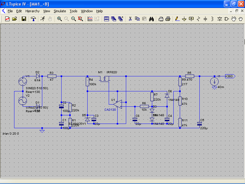

A long ago I did use this
Valve rectification with EZ80, D3 and D4 are only for the simulation, I did use a noisy LM385 1.2 (reverse the polarity!), almost any power MOSFET should be OK, I did use STP6N60 from TV PSUs.
R9 is a trimpot of about 1Kohm.
This circuit was intended to replace a TL783C, unobtainable here at that time.
All Op Amp sucks, so use your favourite one. 😀

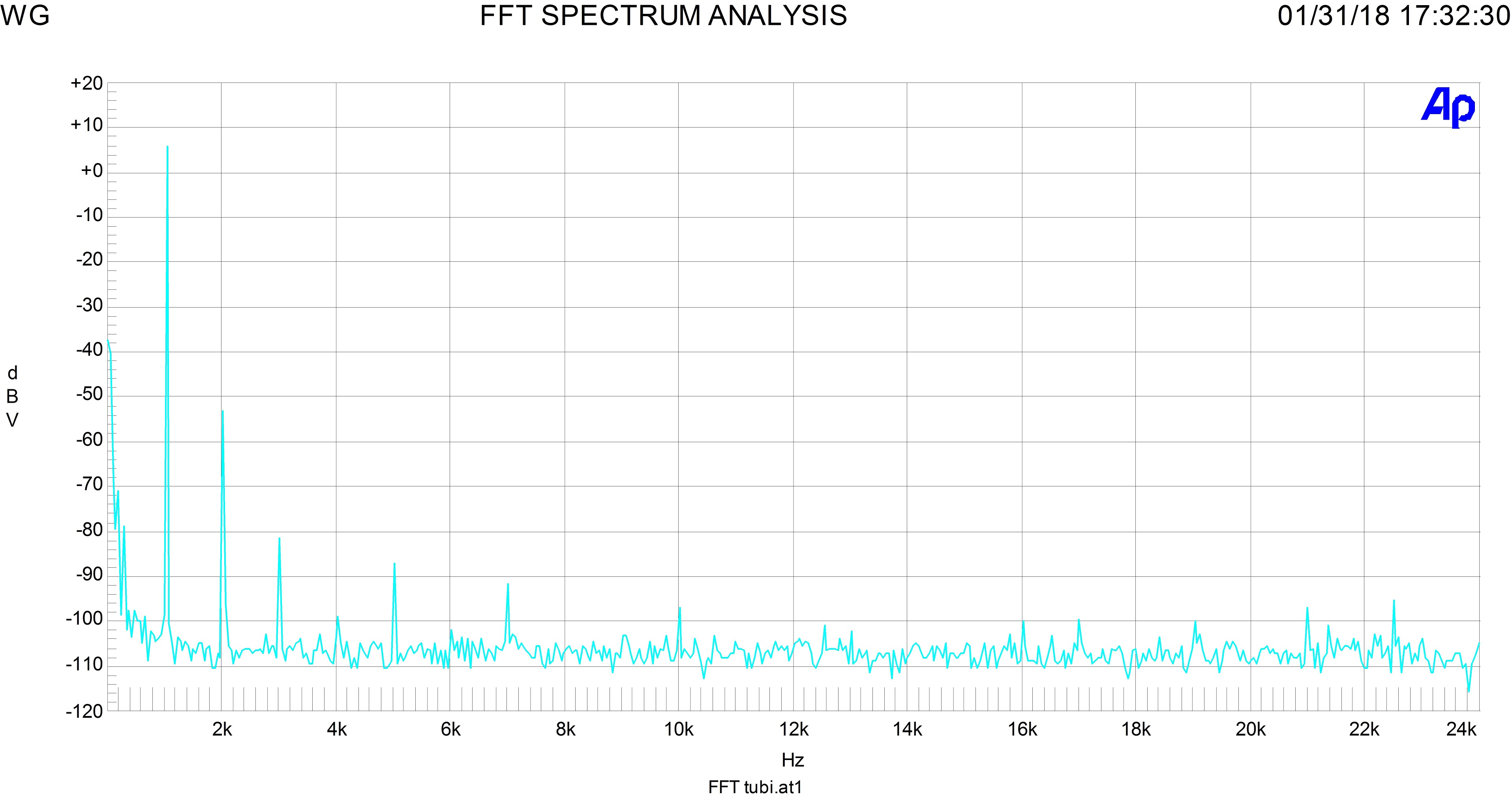

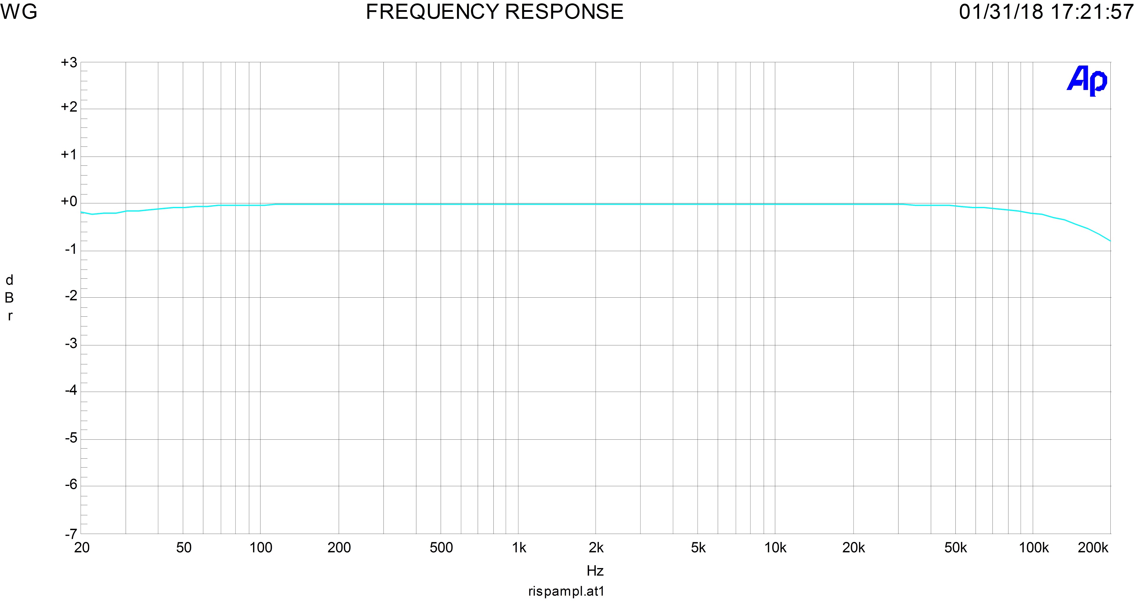

In attach a REAL mesurements of a SRPP of EL84 in triode connection ( for an article on Audio about this tube in different configuration of preamp and amp).
I like this configuration.
Walter

Walter, what a surprise!
I did play with the EL84 in triode mode, very linear, but the "Cinderella" ECC82 in SRPP with a +B of about 650V (!) is absolutely amazing, try this for your next article.
I like your results by the way.
