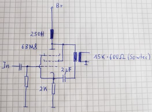

is it OK to use a (relative) low primary 15K Ohm transformer on a parafeed output circuit like used by Western Electric?
Please check this schemo. Thank you.

I wouldn't consider that low for that particular valve. Is this for a linestage?
I would recommend a cathode bypass cap though. Also if you move the 2uF cap up between the plate and OT, the B+ voltage won't appear on the primary winding of the OT.
If you are planning on using a grid cap anyways, why not just use battery bias on the grid and ground both the cathode and the parafeed transformer. Why avoid the cathode circuit, when you can eliminate it?
You could also replace the choke with a CCS. It would be a better load, and it would save your quite a bit of cash.

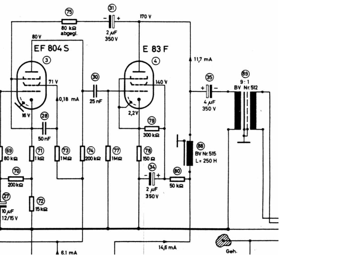

Telefunken (TAB) did another variant of this line output in their famous V76 studio tube amps, altough with a much higher ratio (50K: 600 Ohm) on the output transformer. Thats where my questions occur, but their schemo is slightly different to the old WE designs.

Well, I could be wrong here but it seems to me (1st post) that the anode choke and the IT primary are in parallel wrt the anode. That would implicate their values subtract and would call for a very high self inductance IT to maintain adequate LF response.

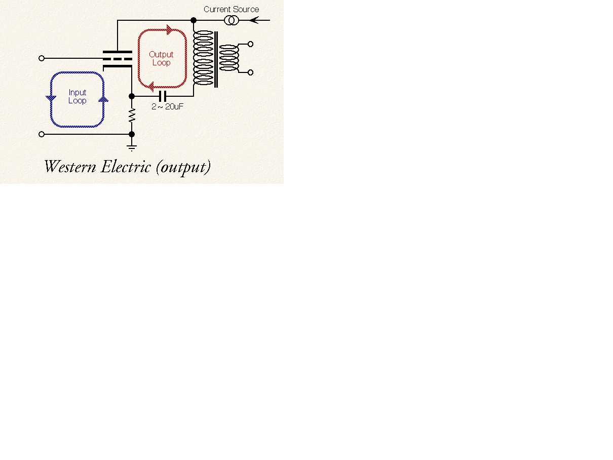

To bring more light in it, here are the two input and output loops contained in my schemo.

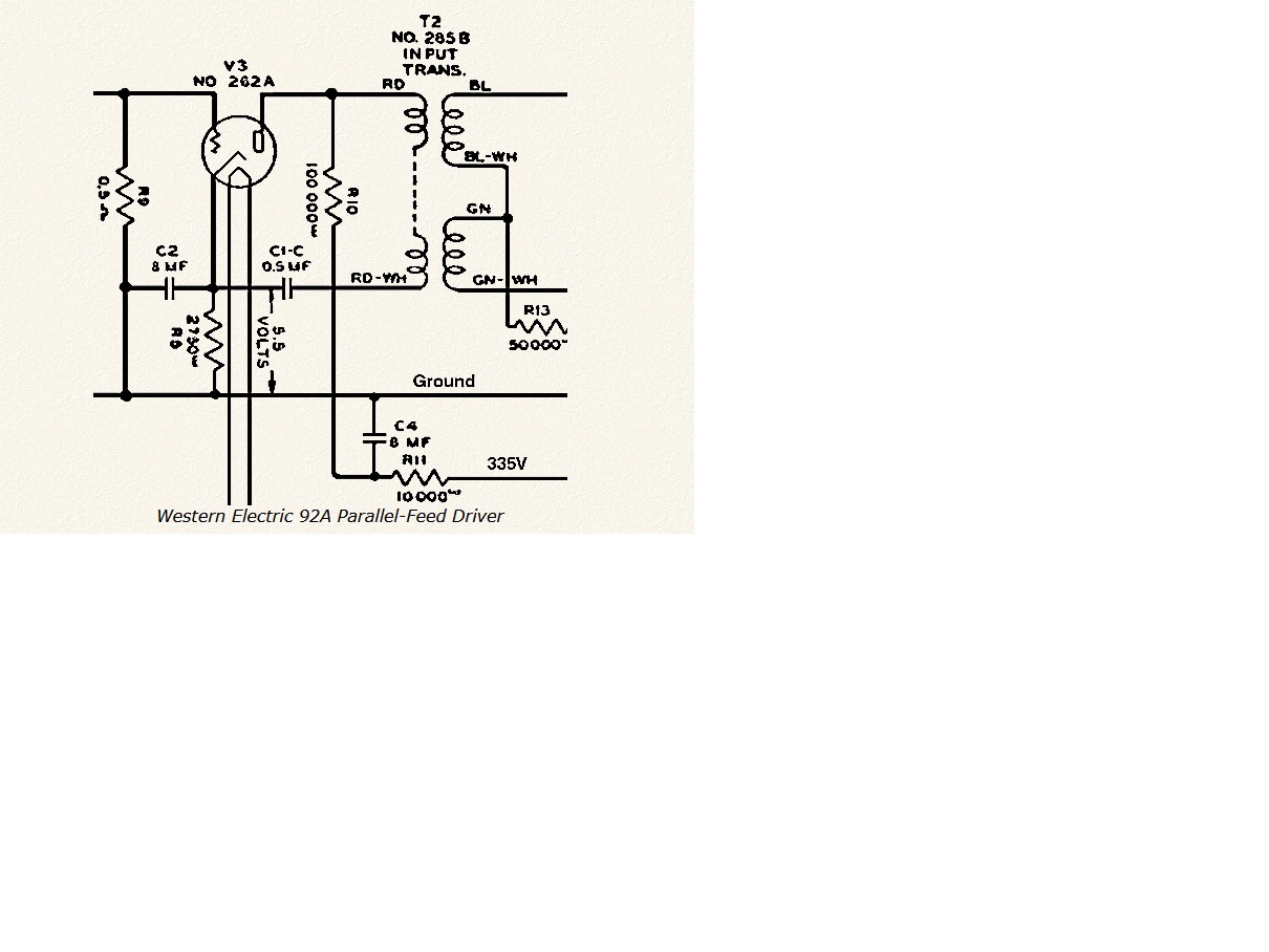

It's a standard coupling circuit which could be found in the WE 92 amp and in some other models of their famous product range.
They used it as a parafeed 4K:2K output in their 32A model.
Unfortunately, I miss data for the WE 285B interstage trans.

At low frequencies a current source has a high impedance where a choke has low impedance, not? In your suggested circuit (below) the choke takes part of the output circuit. Hence the interstage primary receives less energy at low audio frequency.
If you are uncertain how to calculate the necessary inductance for the IT primary for say -1dB @20Hz, there are enough examples around at the forum which I do not know by heart 😉

Plate choke in my schemo was oriented by famous TAB V76, 270H. Just the tube has been changed to a low impedance trioded pentode instead of a E83F pentode. Current is nearly the same, too. The only difference is, output transformer is coupled at the cathode of the tube instead at ground. It's not a question of wether the principle is working or not, it's just a question of "how low can you go" with the output trannies primary impedance.

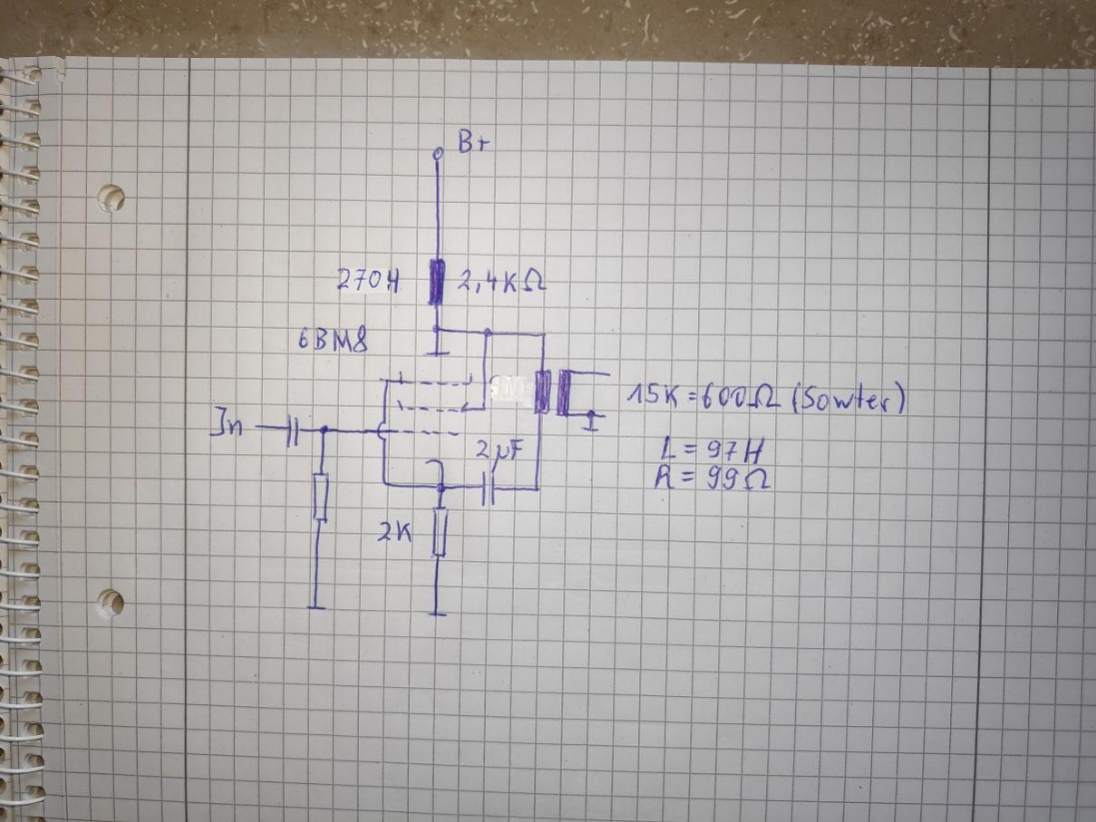

Primary DCR of the Sowter is 99 Ohms (measured), inductance L=97H. Means the parafeed output transformer has roughly the same inductance as the output tube (at 10 Hz).
Will that be sufficient for my drawn schemo?
