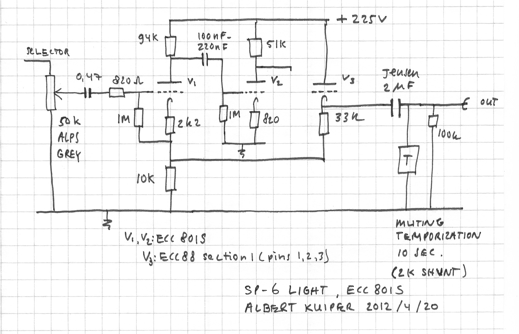

A tube preamp for the F5
With my F5 I wanted a preamp,
  • with extreme dynamics
  • cope with complex passages
  • render the color and timbre of instruments
  • display the depth of the recording space
  • highlight the position and movement of singers
  • solid bass that retains the image irrespective of the dynamics (punchline)
  • depth and easy listening (no projection)
  • something like 14-16 dB only
  • no hum or artifices even at highest volume setting (it is flat open that I mostly use)
For some time I used an Aikido 6SN7 version, but I found it did not resolve well enough, it did not match the dynamic capabilities of the F5 and I heard some harshness maybe indicating slew rate limiting (choirs, violin sections). Even though the units measured well and did generally sound good on a 300B PP amp.
I made a clone of the well-known Audio Research SP-6, using ECC81 instead of ECC83. It took me quite some time to get all the details right, but the result now can be shared.
The result is more than satisfying. A big improvement in the bass section and I have very stable mid highs now. An other improvement is that the sound stage remains the same independent of the volume setting. Before I had only heard that once with the best digital volume control at Guido Tent. So yes, very, very happy.
  • I do have a delay switch on the output that shorts the output after the coupling cap with 200 ohms for 10 seconds. The DC over my speaker is maximum 2,5 V DC in this period.
The BW is 1- >300 kHz, Vout max is about 25 Volts RMS. So yes, it can be overdriven without a problem. Distortion less than 0,1%, second harmonic.
In the mean time I also made a 6SN7 version (that also tests excellent) but I have not listened to that yet.

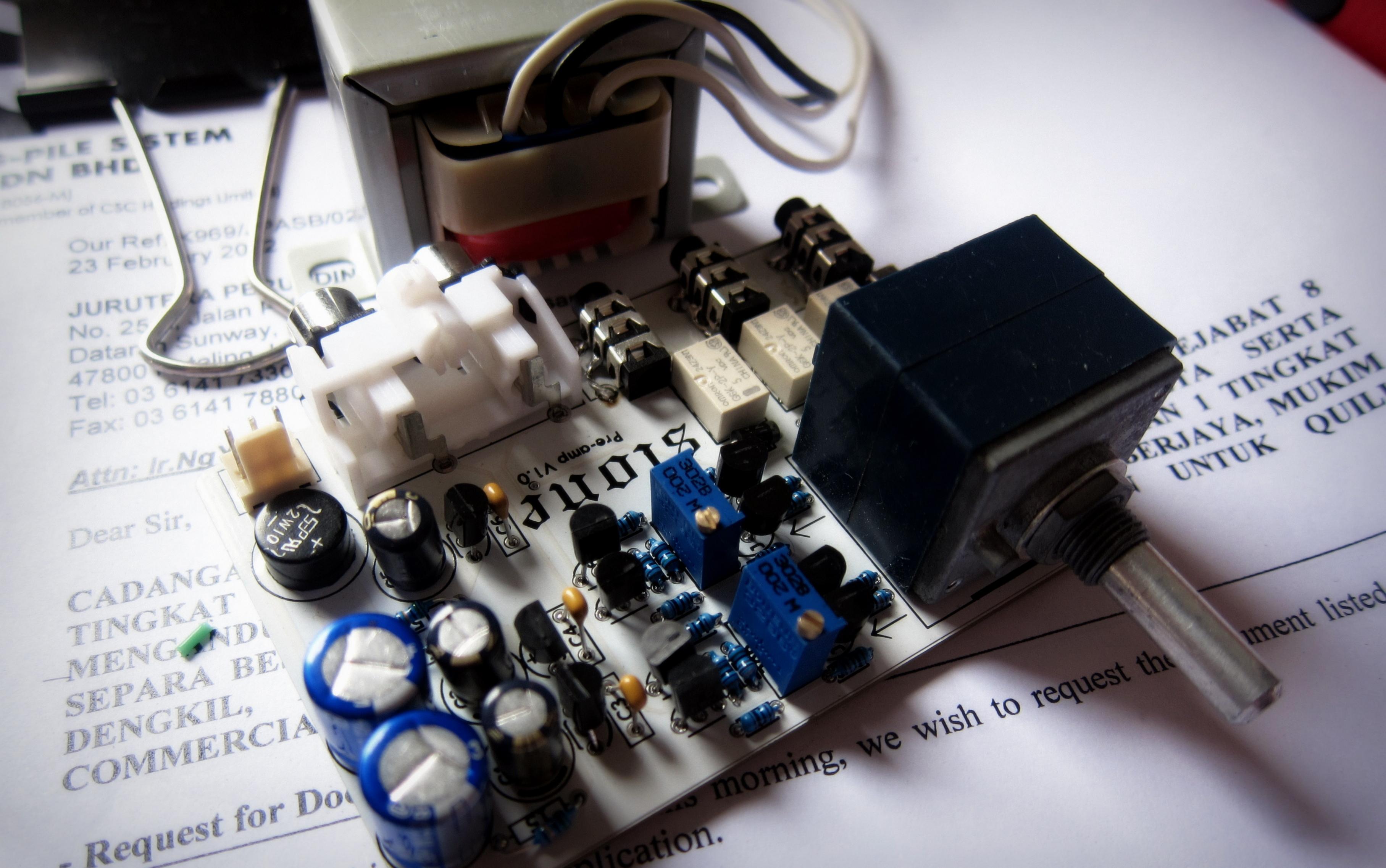

Thanks. I am using the schematic from post 53rd. 🙂
Subjectively, it's giving me sparkling high than never before! 😱
...very nice one! parts ordered yesterday, can't wait to build it! 😀

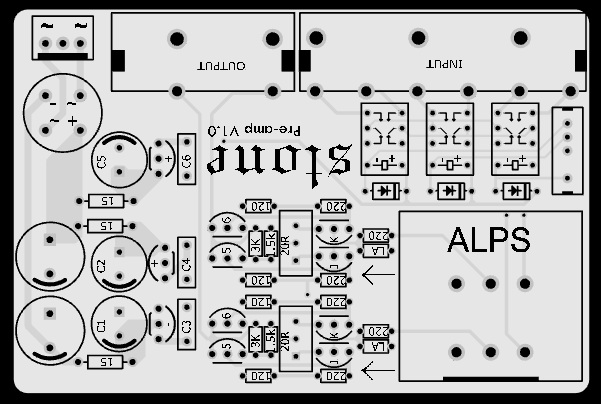

I found some differences in your PCB and the Layout: The C numbers are not the same. (in the PCB C3 is a small one, in the layout it's a big one with polarity)
Is the layout correct? It would be no problem then, I will do it on a experimental-PCB.
And is it ok to use 12V-R-core transformers? That would give me about 16V DC, should be enough for the 78/7912, correct?
