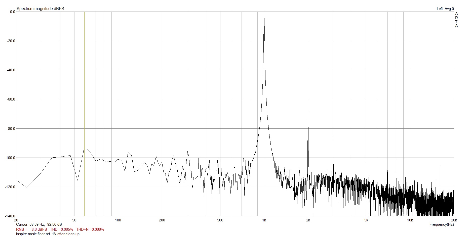

Here's the noisefloor at 1kHz. Tomorrow I will take off all but one of the terminal strips, slip #4 shoulder washers in, then cap them off with a plastic acorn nut, then do a thought out ground buss that starts at the power supply and terminates at the chassis plate up around the volume pot.
I should be able to reduce that noise by about 20dB.
Noise down -65dB wrt 1V means there's 500uV of noise at the output jacks. That's not great for a linestage. If you have a power amp with 15dB of gain (which would be really low), then you have about 3mV of noise at the speaker jacks just being contributed by the preamp. This is way too much if speaker sensitivity is at all high.
If I got that noise down to -85dB, then there's 50uV of noise at the output jacks of the preamp and 0.3mV coming out of the low gain amp, which is quite tolerable.

What ultimately ended up solving the issue was swapping the heaters from AC to DC on my bench supply. I do absolutely believe that this circuit could be made to work quietly on AC, but rather than redressing all of the heater wiring, I'll just put in a small DC supply and be done with it. With DC heating, SNR goes from ~65dB to 87dB, so this is totally workable.

Out of curiosity, did you happen to make a measurement after just removing all those redundant grounds?
No, I just kept going at the thing until it was sufficiently quiet. I wanted to make sure the 60Hz and 120Hz lumps went more or less all the way away before I stopped.

That new plot is pretty amazing...
