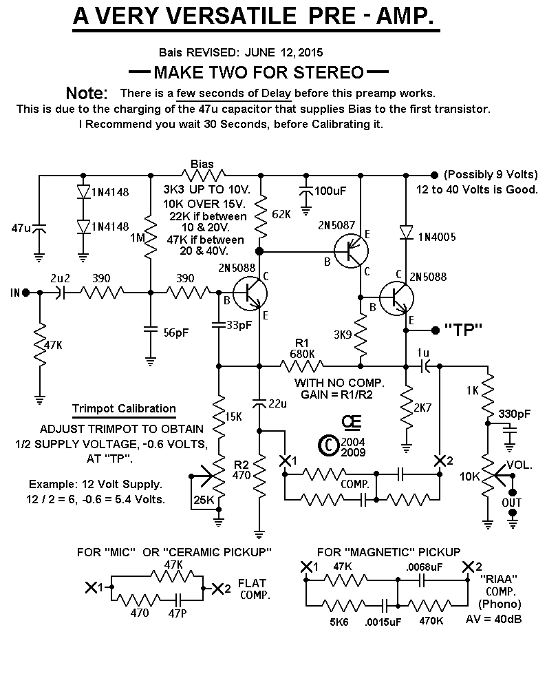

I'm using a MiniDsp for its DiracLive function and running it into an Emotiva amp. However, Dirac Live exacts a 20 db penalty (something about not running into digital clipping) so that the MiniDsp is running nearly flat out but my music doesn't have near the dynamics it did - just sounds flat. Jumping around the MiniDsp restores proper dynamics and volume levels.
I'd like to build a simple opamp preamp to put between the MiniDsp and the amp. I'm thinking a dead simple fixed gain preamp based on a OPA2134 with a gain of 10 or so - what do you guys think and can you sketch one out for me? Thanks in advance for your help.

Doing some more thinking and exploration, I don't think I need a gain of 10 circuit but perhaps a gain of 5. I need to get some measurements but I would think the MiniDsp ( without Dirac ) would be outputting 1 - 2v into the amp at max volume so I just need to get back to that I believe.

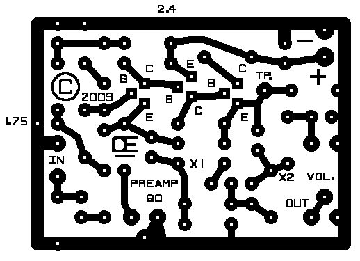

Here are a couple of single supply circuits that might fill your needs for a 2gain or 4 gain boost.
The panasonic, I'd eliminate the 2n3055 output transistors and maybe cut spreader diode D2 leaving D1 plus a series pot. You don't need amps of current out, only 50 ma. You want idle bias current in Q3 Q4 to be about 10 ma. You can lower the output capacitor to 220 uf and cut the power supply to a single 12 v. For Q3 Q4 I'd use BD139/140 or MJE15028/15029. Put little heat sinks on them.
The chemelec, obviously use the microphone input option lower left. I'd use MPSA06 MPSA56 transistors, they are very quiet. If you can't get those, 2n5401 2n5551.

Line level sources, though have more than adequate output.
You are obsessed with signal purity! Line level has changed over the years. Now most power amps will produce full wattage at <1 vac. Many newer ones will produce full watts at 0.7 vac. Other on diyaudio have also complained about low volume out of DSP's.
Standard line level in 1961 was 1.6 vac. OP has a objectionable volume difference between his unnamed source and the amp. I have had this problem also. I can't use the line level output of my CD players on the older amps, I have to use the earphone jack turned down. It always doesn't trash signal to noise ratio to boost signal by 2x. If I had any improvement to add to circuits post 5 I would put 100 pf ceramic cap to ground after the input cap of them. RCA cables can pick up AM CB & police band radio in my location, and RCA cables can't be bought less than 3' long.
