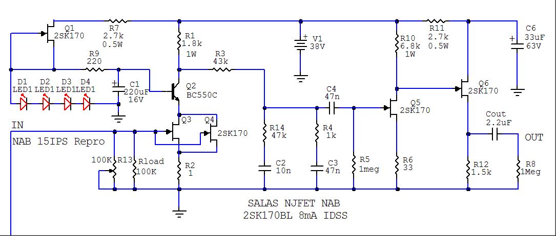

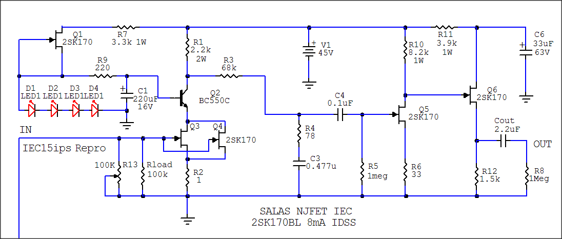

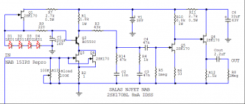

I had been asked once to embed NAB and IEC by a member but heard no news. Here are the circuits since it took me enough time to investigate. Maybe someone with open reel finds them interesting to test their fitness or tweak a bit from there.
edit: revised NAB circuit

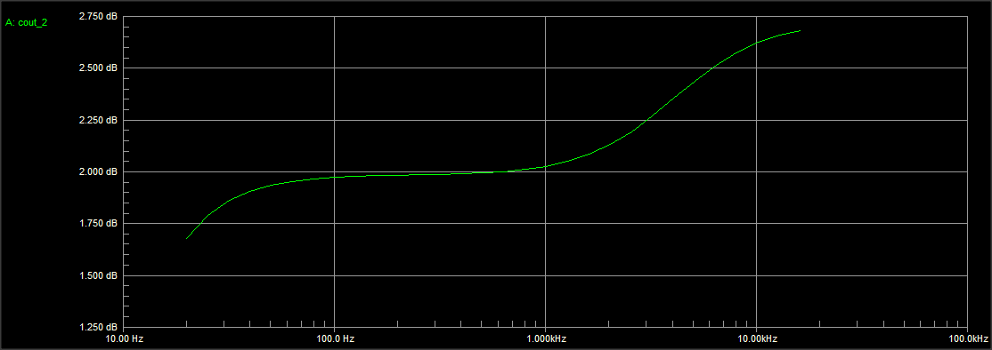

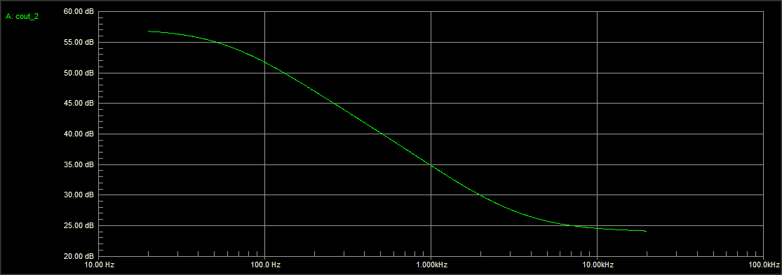

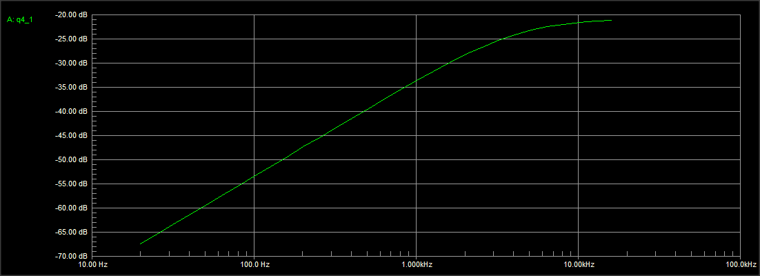

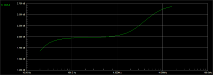

Here is what the above circuits do by the way. First pic is the input IEC response that is corrected to flat by first circuit. Second pic is the NAB correcting EQ the second circuit imposes on the play head's signal. Open reel aficionados may examine. Both are for 15 inches per second. The input trimmers are for loading both low and high impedance heads better since load can affect their HF I had read.

Master Salas,
What imp/resistance head did you model? Does it matter?
And if I wanted trimmers for gain and freq response, where would they go?

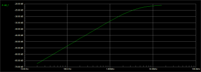

I used 5mH lower impedance later heads assumption, and about 350R source resistance. The input does not care but the heads may care, hence the trimming load addition. Good multi-turn trimmers in the passive EQ section (R4 HF) and R10 for gain. Very sensitive in the IEC for R4, see how it goes for 85R example.
P.S. Its only a theoretical exercise remember, it should take some work from here when with the real reel beast at hand. Don't know for peak overload for instance.

5mH, isn't to low for a PB head?
Just a small detail I'm not that hardcore in electronics....
Why not learning from the Master? Mr. John Curl, a leading expert in the field of tape recorder electronics, is a member of this forum. Try to contact him.
Have read in a Manley manual 2mH to 10mH for most heads in solid state decks.
