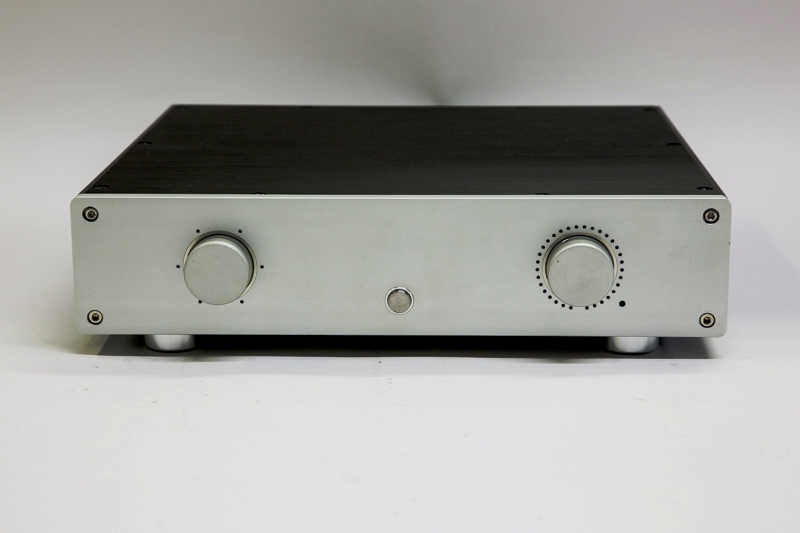

Finally, Fran found some time to finish both the power amp and the preamp for listening.
www.diyaudio.com/community/threads/hiraga-le-monstre-2024.413301/post-7879347
We have now everything proven, and can publish in time before 2024 comes to an end.
For 2025, we still have some refinements for the ladder attenuator planned, as well as building and measuring with other transistor combinations.
In the meantime, happy reading.
Merry Christmas and Happy New Year,
Patrick

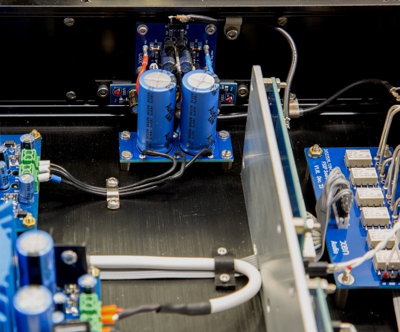

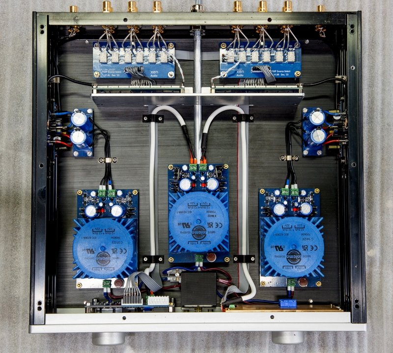

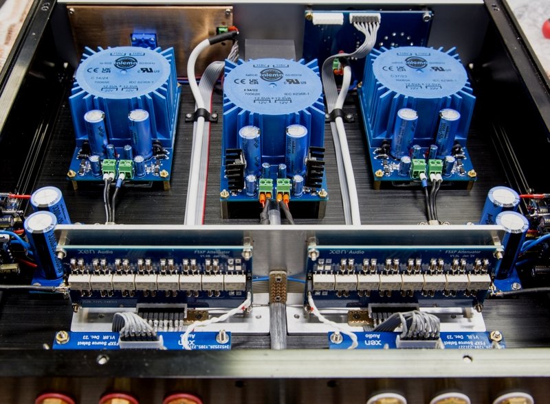

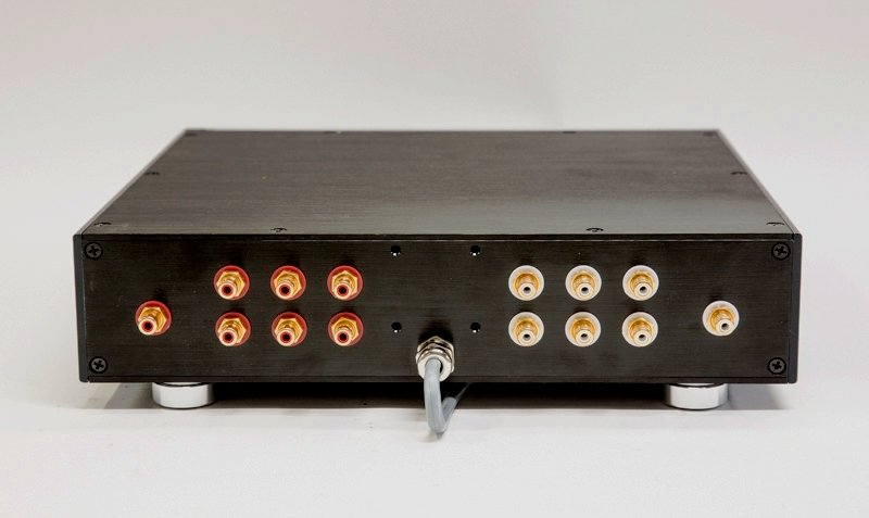

More pictures.
Patrick
PS Note the nice little black cable clamps and the mains switch cover at the front.
3D printing comes handy. 😊
