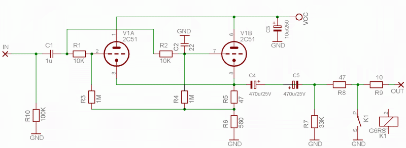

Why make it more difficult than nessesairy 😕
Like this you can adjust the gain between 0 and ~20dB (1x...10x)
The Ne bulb is to prevent high voltage between cathode and grid at start-up.
Mona
Hello Sir,

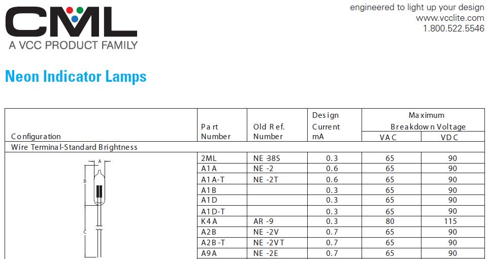

excuse my ignorance, but they are not very practical with valves. You in your schematic you put the volume potentiometer output again, or I misunderstand? you say you put a "bulb It is to prevent high voltage between cathode and grid at start-up" but what is this NE-2 bulb? a light bulb ?? ... Thank you for your clarification.....
It's not a volume potentiometer, but a means to adjust the amount of feedback and hence the gain.
The NE-2 is a little neon bulb, i like that to keep it all tubes.You can use a 1N4148 diode, cathode diode at cathode tube, if you will.

With the cathode current there is some disipation needed, better a bigger one.

Excuse me, i mixed up two circuits, one with the pot.m on the cathode i am busy with.With the cathode current there is some disipation needed, better a bigger one.

Isn't the case here, you can easely use the small one.And, if you allready have the 100k one even better.

The schematic doesn't change, only the value of the trimpotm., use 100k and it can be the small one from TME.ok, if you can clarify with the schematic ........ thanks
I had an other circuit on my mind with the trimpot on the cathode, lower value + more dissipation.The risk when doing more then one thing at the same time 😱

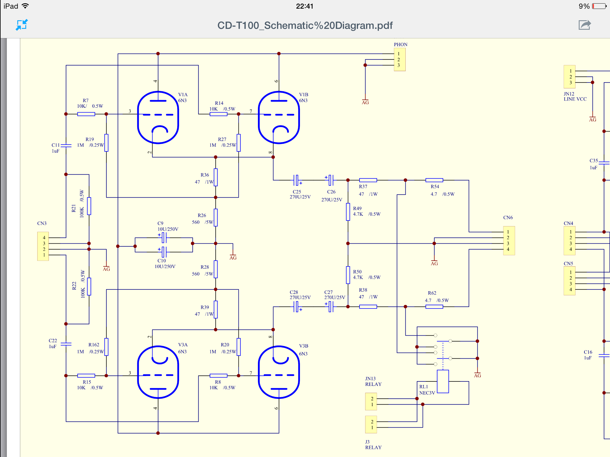

Ckwong99,
use this schematic. It has 1x amplification and can drive headphones.
Schematic is used by NAD and Shanling.

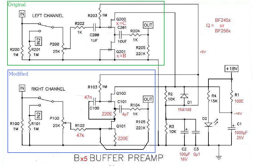

Hi Paul i just want it as the line voltage gain control.
I am using B1 buffer play with dac direct input so the V gain seems not enough.
..for supply fair I opened my page here http://www.diyaudio.com/forums/tubes-valves/304141-preamp-hengpen-13-6n3-advice.html#post4997078
Normally this extra stage would be superfluous as DACs have 2V outputs. Most power amps get enough input voltage from a B1 with a DAC connected to it. Normally a B1 has volume control as per design.
Maybe adding volume control to the B1 as per design solves matters in a more easy way costing less time and making things more versatile with possible other sources.
With a little mod the B1 can give gain too.No need for an extra (tube)stage.Quote:
Originally Posted by ckwong99>
"Hi Paul i just want it as the line voltage gain control.
I am using B1 buffer play with dac direct input so the V gain seems not enough."
Like this you get a gain over 4x.

I bought one of these (the red 6N3 "buffer board") to mess around with as a guitar and/or mic preamp. I eliminated the output pot. It seems to make sense to me to replace R5 with a pot, say 5k or 10k to attenuate by the amount of NFB rather than a pot on the input, especially if I put a step-up transformer on the input. Thoughts?
As an aside in the one I bought I eliminated the output pot, and on one channel eliminated the feedback and stuck a 1M resistor on the input jack. One has a ton of gain, the other makes for a decent "toob" effect. With guitar the lower gain side still has plenty of gain to drive a line input on a mixing board. On a Strat knockoff, on the hi-gain side I have to dial back the volume control to avoid clipping so there is a lot of loss or hum depending on the adjustment of the tone control. Buffering the input with the AMZ Fet Buffer helps calm that.
