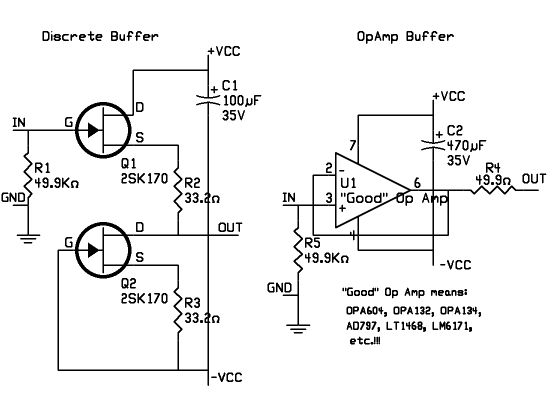

-I'm wondering where I should put buffers? Should I put one
before each 'block' in the diagram? Does anyone know a good buffer circuit?

you want buffers?
I'm not sure what your needs dictate, but here are a couple of VERY simple ones that have worked well for me over the years. Tweak to your heart's content!

PS: Since you'll have to use +/-12V rails analog rails because of the SSM2404, you may want to look at the AD8610 op amp as a buffer since its max rails are +/-13V.

First off, I'd suggest a buffer on your tape output. You really should isolate any loading effects from your tape deck's input.
You mentioned everything is remote control - what are you using for a volume control? You may need to buffer that. Or how about moving the volume control in front of the preamp section?
Some of the SSM24xx switches suggest you should drive into a virtual ground, meaning you'll need an opamp there. Check the app notes on the 2404 carefully.

Re SSM2404: I used these in my preamp for source selection. My circuit is based on Fig. 23 or 26 in the datasheet: A 5K resistor before, running into a virtual ground opamp. You can extend Fig. 26 to as many inputs as you need (only selecting one at a time, of course). I don't have the input protection diodes but they seem like a really good idea.
Re position of volume control: If it is after the preamp, your output impedance will vary with volume setting. This may not be a big deal if your preamp is close to your power amp and the latter has a high input impedance. Otherwise, I'd buffer after the volume control. If the preamp has a significant amount of gain, putting the volume control afterwards reduces the noise from the preamp as the volume is lowered - also desirable. Your call. This is what makes it fun and why we keep building more and more and more. I like your idea of putting everything in then being able to bypass it.
Re potentiometer: this topic comes up often on this board. I believe there was also some discussion on the Dallas (Maxim) parts at headwize.com. Typing part numbers into the search will usually get lots of hits. Many digital pots can only practically be controlled from a microprocessor, which is probably either not a problem or insurmountable, depending on your electronics background.
Re LM6121 (or LM6221): probably overkill. Really expensive.

I found a unity gain circuit in the welbourne labs catalog. I attached the image. Can anyone tell me if it's a good one? Does it worth it to go with this or there are better up to date circuits (this one is from 1990).
