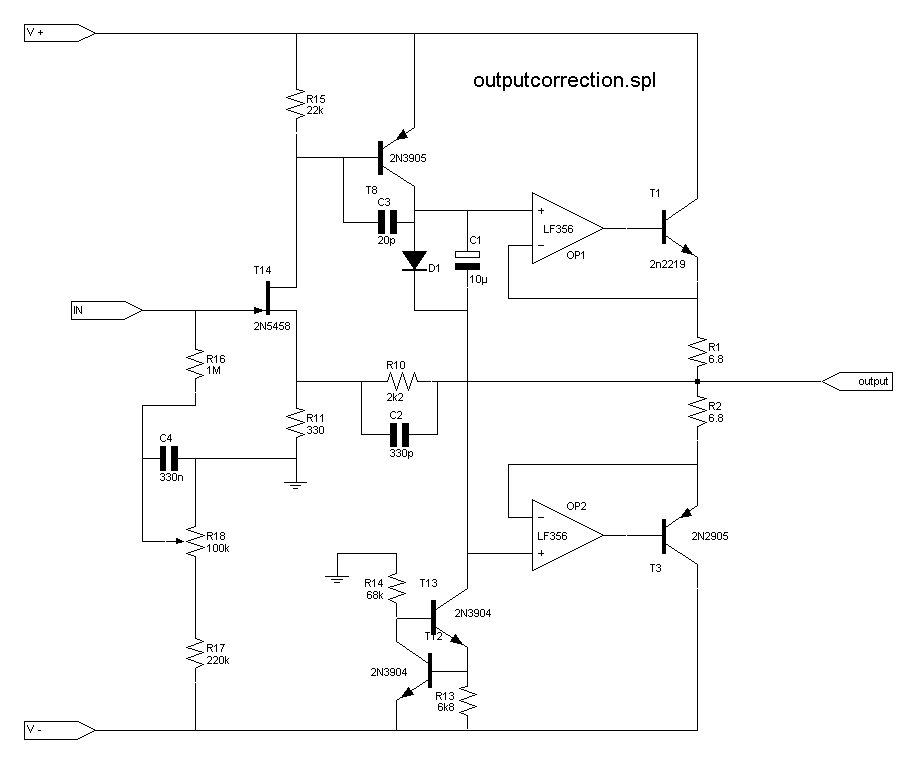

preamp configuration
sorry......... here is the circuit...
