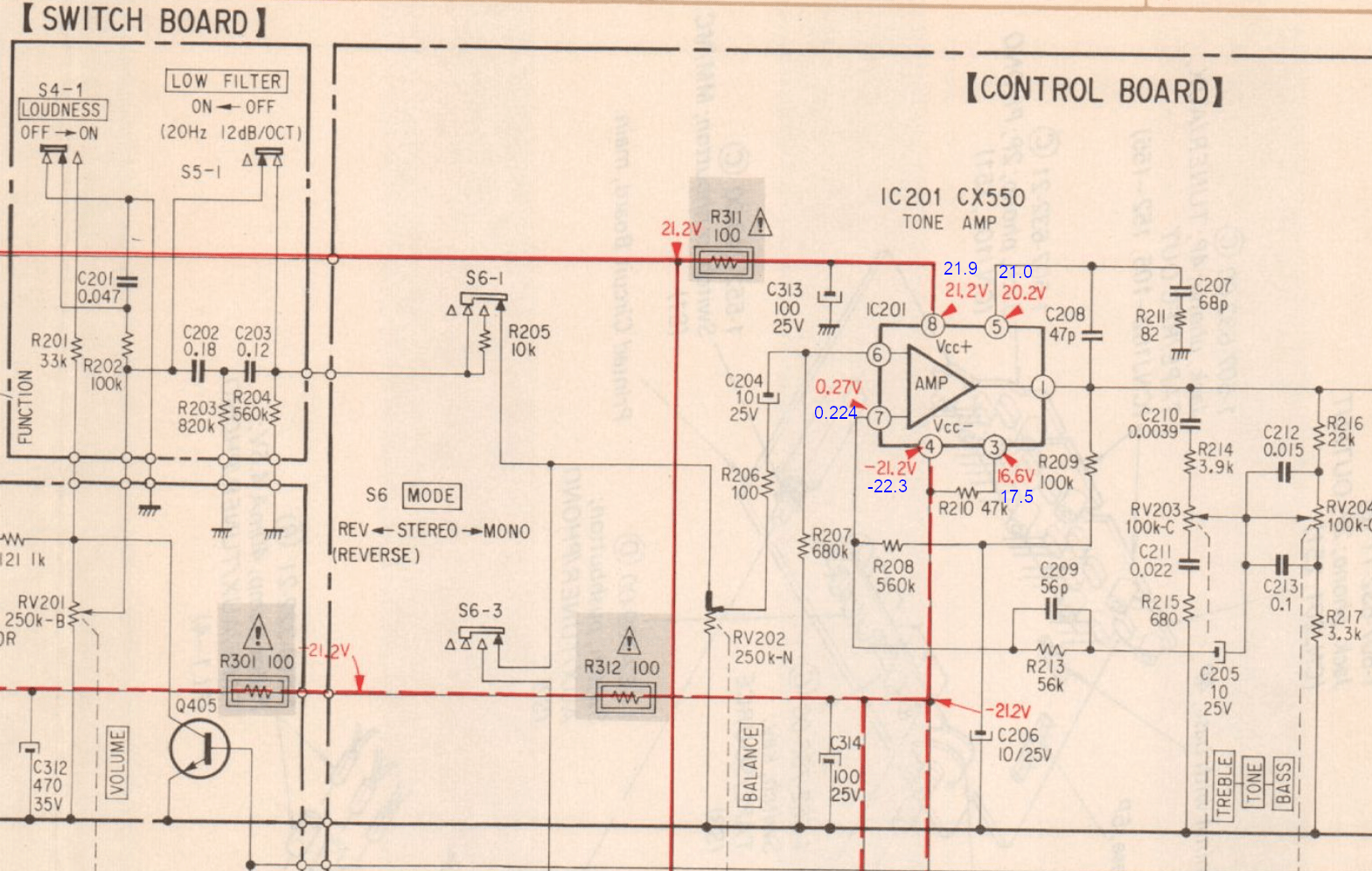

I downloaded the service manual, and have taken measurements at the points specified. A few things stand out:
  • The voltages on the main opamp ICs are out of spec, probably due to power supply issues
  • the +31V and -31V lines are running over spec, at 32.7V. This is probably because the preamp is rated at 220V and the power here is 230-240V - but it should be able to cope with that.
  • One particular voltage is way off spec - the collector on Q401 is reading -21.3V when it should be -24.5V. My best guess is that this is the issue that's causing the preamp to misbehave.

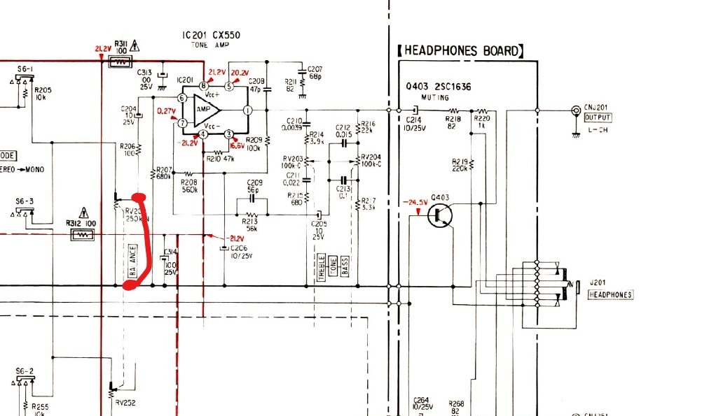

That takes us to this section of the board - where, again, the voltages are a little out of spec. I've checked the other components as far as I can, and the numbers on the resistors and electrolytic capacitors are where they should be. If I've read the circuit diagram correctly, with the loudness and low filter switches both set to OFF, that should take all the components on that board out of the circuit, so there's no need to look there. Do I need to go around checking the film caps, or is there some better path to investigate?

Look at the circuit. You need to look at the end of R311 and R312 that feed the chip. Use AC coupling on the scope and look at the rail. It should be clean, nothing more than a millivolt or two of noise and that noise depends greatly where you ground the scope.
The bass and treble controls are part of the feedback loop and so are critical to all of this. Do they actually work as expected?
Look at the circuit. C205 is the point where the signal is fed back into the inverting input of the opamp. You need to check carefully that all the parts in that area are the correct value (not been changed by someone). Check the pots are the correct value. Check that with them centred you read around 50k from the centre wiper pin to each end. You can isolate one end of R216 and R217 to isolate the pot and get a true result. The treble pot should be isolated by the caps and you should be able to read that one in circuit. Check R216 and R217 are correct values. These set the gain (with the pot resistance).
Check R214 and R215 are correct and that the caps C211/212/213/214 are correct values.
C205 seems an outsider for a fault like this but as it is in the feedback loop it needs checking. You can just bridge it with another.

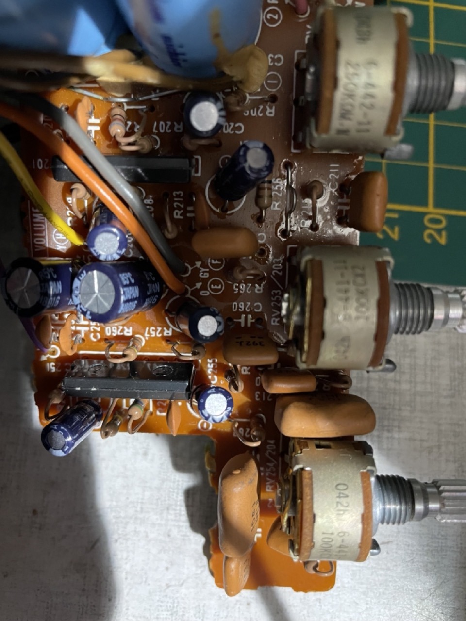

I took the cover off and got to the tone amp board, and aside from the big film cap between the bottom two pots having a bit of a bumpy shape, everything looks normal and original:
The pots work more-or-less as expected - they're not linear variable resistors, they're stepped, and whilst the resistances go from zero at one end of the sweep to nearly 100k at the other measured from both ends to the centre, the split in the middle is more like 12/77 than 50/50.
The resistors R216 and R217 measure correctly.
R214 and R215 also measure correctly; the caps C209-C213 all have the correct labels but my probe (a Uni-T UT116C) won't show a reading for them in situ.
My probe did measure C205 and it shows a correct reading of roughly 10uF. I also checked the other electrolytics around the tone amp for good measure, and they are all within spec.

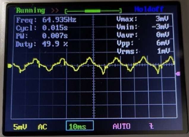

I took some more scope readings, and I noticed that the noise had something of a pattern to it:

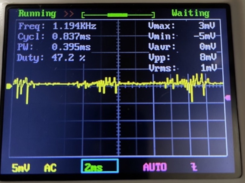

and when the treble controls are turned all the way down, it stabilises into this (note the different time scale):
All of which shows that this is a complex feedback loop that I don't yet understand the details of, and leaves me wishing there were a tone bypass switch that would isolate this stuff to make diagnosing it a bit easier. 🙂
I also noticed just how sensitive this circuit is - when adjusting the EQ knobs, the capacitance of my body sent the output up to 200mV.
My mistake on the pots... the 12/77 split will be because they are a 'C' taper which is a logarithmic pot. So I think we should say they are OK.
This is strange then. The pattern to the noise does not look like normal 'hiss' which just doesn't look like that. This image from the web shows exactly how hiss looks on a scope... but it needs a wideband scope to show it like that.
