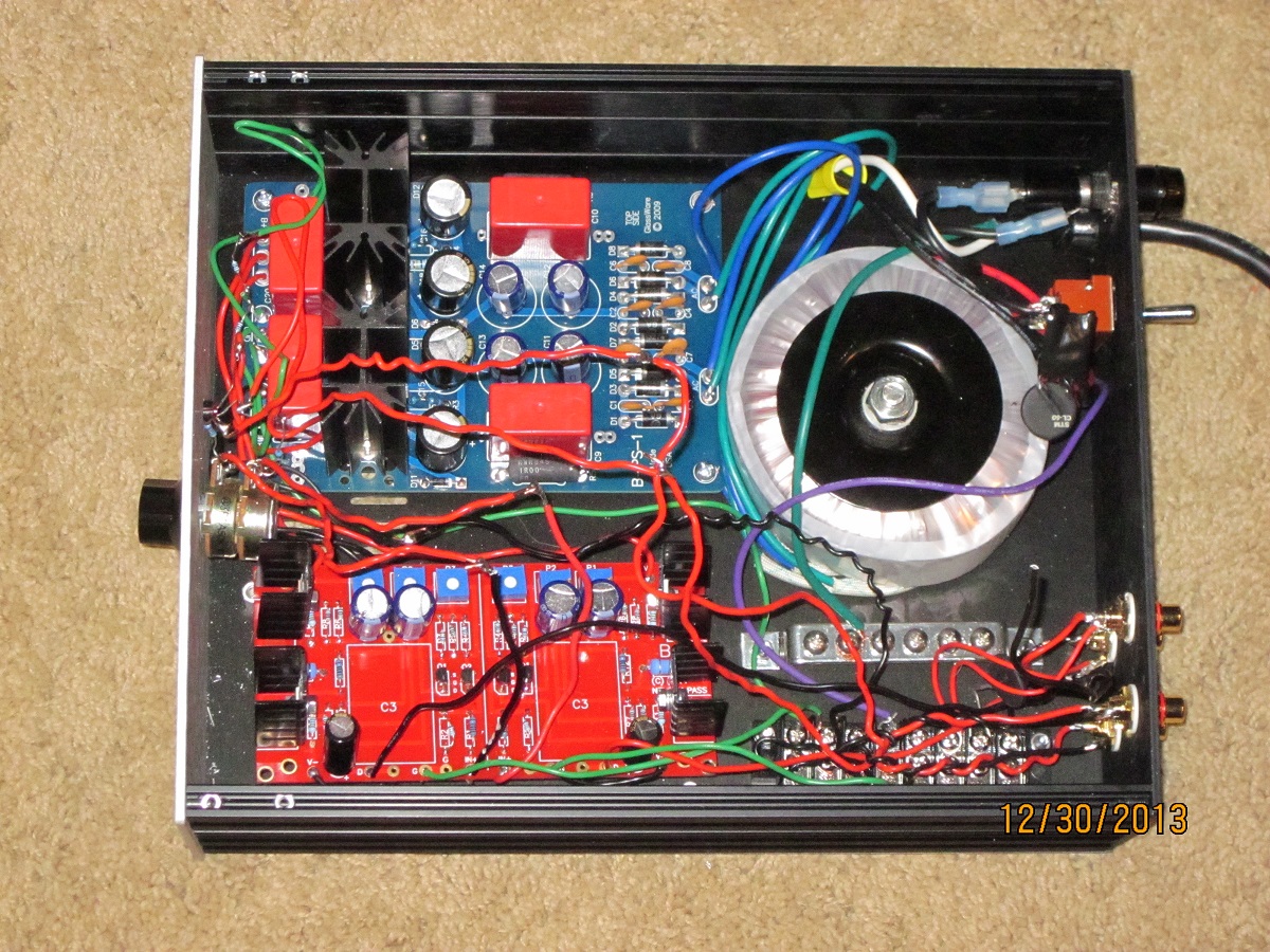

I had a similar problem with a Burning Amp, and I built a low-gain line stage using the BA-3 front end.
Power transformer: Antek 18V 100VA
Power supply: Broskie B-PS-1 bipolar regulator set at +/- 21 VDC
Voltage Amp: BA3 front end set with a gain of about five (13 db or so)
Volume control: a 50K pot, in a shunt config with a 47K resistor.
Enclosure: Galaxy 288 chassis
It is dead quiet, using the standard star ground and CL60 technique. (I was surrpised especially with the way everything is jammed in).
